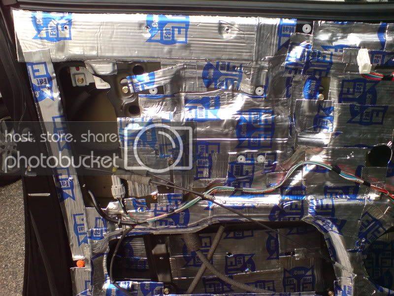

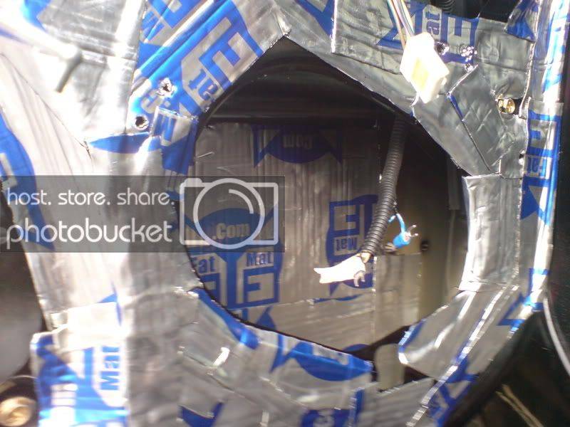

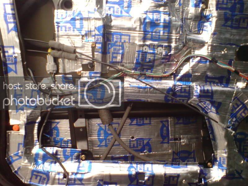

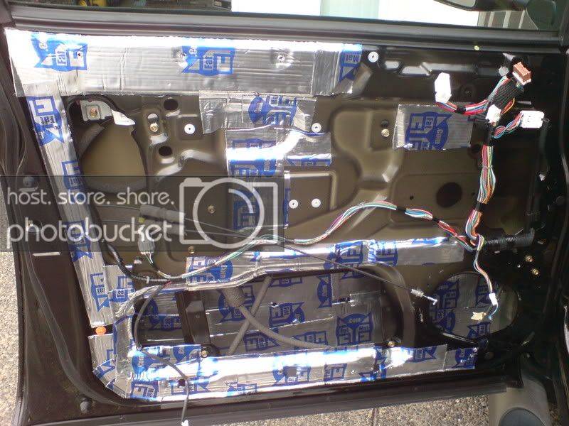

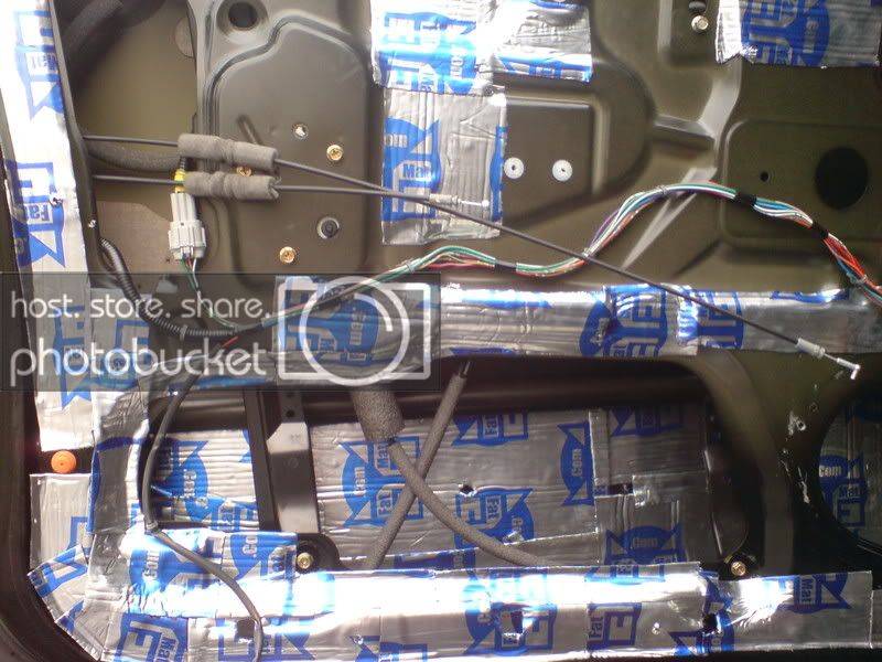

I put fatmat and installed my hsk in the driver side door today. I dont know if i did a good job but here are pix.
i have 2 huge rolls of this stuff. I think i used between 25-35% of one roll on this door. I put 2 layers in that area behind the speaker and the whole lower portion of the door.
hmmmmm seems like i need to add more then lol. I will have to remove the panel anyhow since i can see bits of deadner poking out.
usually people cover the entire door not just bits and pieces. also depends on the car though. i know my civic door is like a tin can so it needs alot. my ***** am door not so much.
Covering those holes is a must. It will help bass response alot.
Most of those contours dont look that deep, no need to use such small pieces. The more you practice, the larger a piece you'll find you can lay out and not get any tears or bulges.
The aluminum does not stretch, its not like the old asphalt stuff you could just heat up and stretch any which way you wanted. So with crevices, you lay the mat a bit at a time, using your fingers to mold down into any of those depressions, working from one side to the other. The trick is not just trying to stick the whole piece up all at the same time.
The larger the pieces you can lay at one time, the faster the project will go. Those door pics look rather time consuming for an area I would have done in 1-3 pieces (inner skin).
Are you talking about those small holes in the door or the spaces inbetween pieces of fatmat? All the little holes were already there so i punched thru the fatmat, i figured they must be there for a reason.
