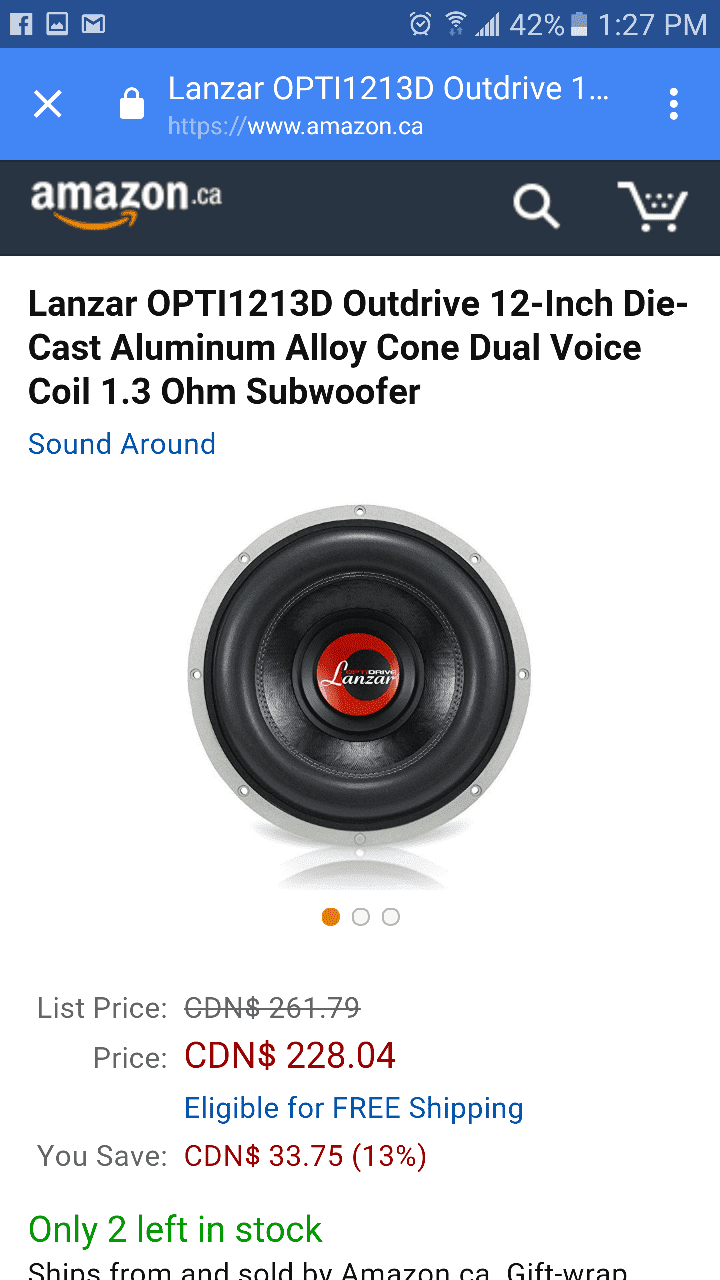

Anybody have any input on theses are they a good splq. Sub .They are on amazon canada free shipping 1.3 ohms . What ohms can they be wired two . Sorry for asking same question twice but I noticed these are a difrent ohm subs as mentioned earlier

Anything with a . after a number, it's always gonna be that ohm no matter what. So you you have 1.3 or 1.2 it's 1 in the real world, even if the DMM told ya diff and it matches the 1.3 anyway.
Same with other impedance subs. Mine are d4 ohm each....but prob measured 4.3 or so.
