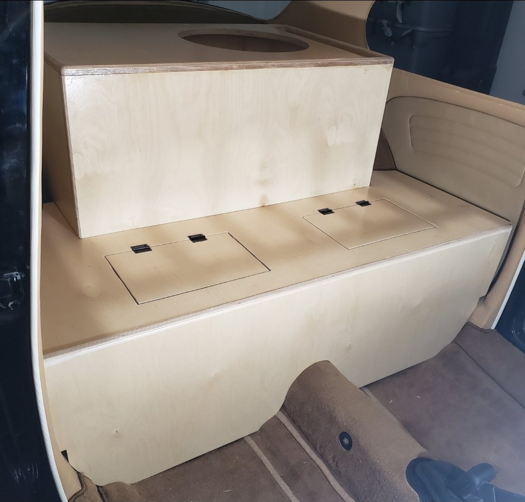

1/2” birch ply sufficient for box build?
I ended up finding an 11 ply plywood board at my local Lowe’s. The exterior 2 layers are very thin so it’s more like 9 ply. I’m going to start the box tomorrow so I’ll report back. Going to do a window to show off the Brahma magnet 😉

I’m using an 11 ply wood I found at my Lowe’s. Literally the last piece they had and it was hidden in the back. Actually got most of the box built today
Good! I didn't use any screws on my box either. A lot of brad nails and glue. Then, wood filler and a lot of clear. I also siliconed the inside of the box. Just an idea.
