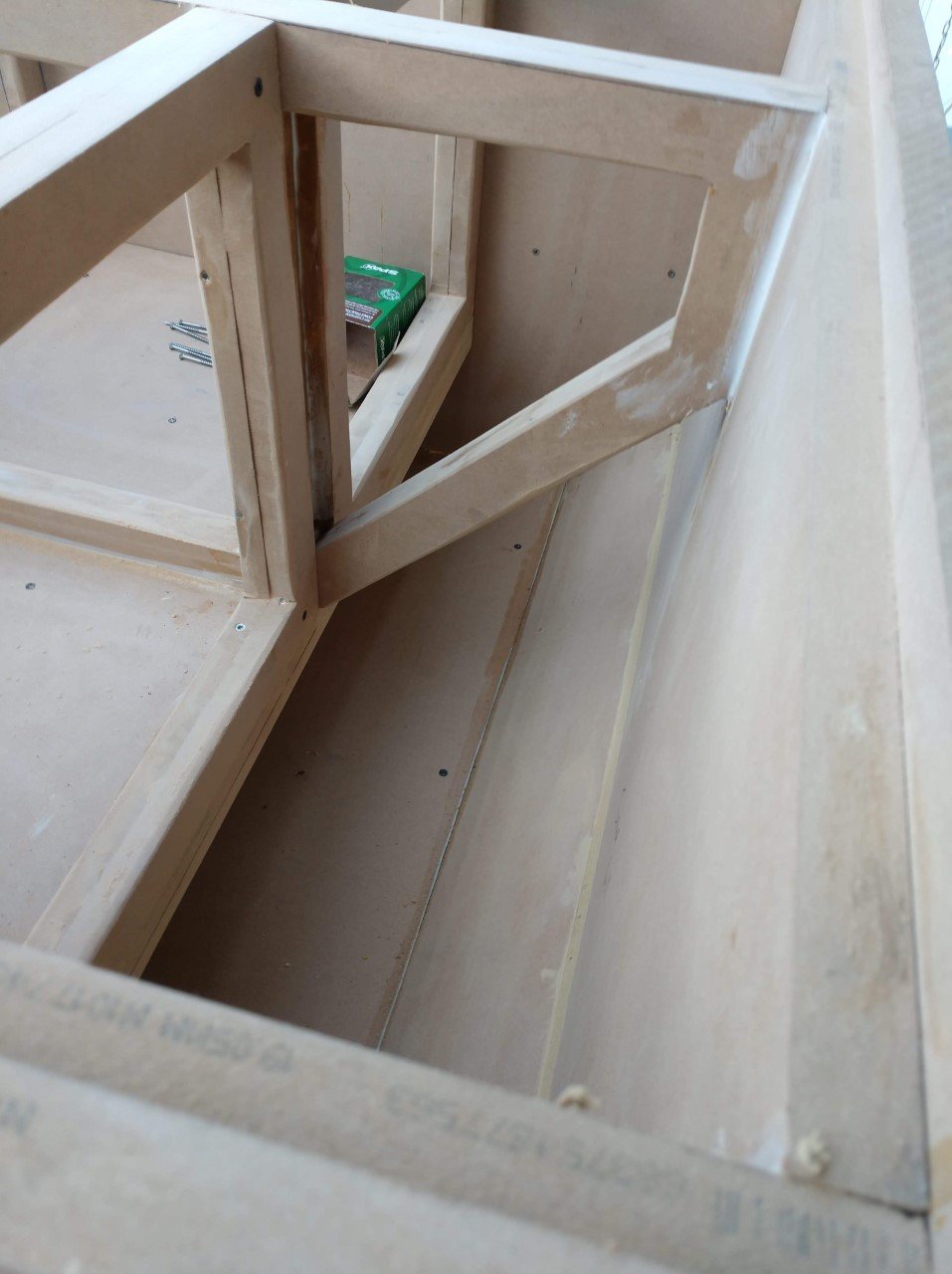

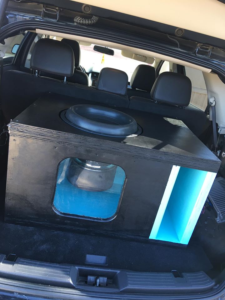

HDF boxes btw...
27005
27015
27007
I'm NOT a small sub guy but will admit they can do the job. He did a dual Xfl-12 box that pushed 150db with that Hdf so it's solid, but materials always factor in the design.... Ima geek like that... sorry. Rise and all.... lol, We use 6" lag bolts /w/ resin and PL down here in Az to hold OUR boxes down (less rise). 👀 100% #Facts... we got a bridge for sale on the border too.

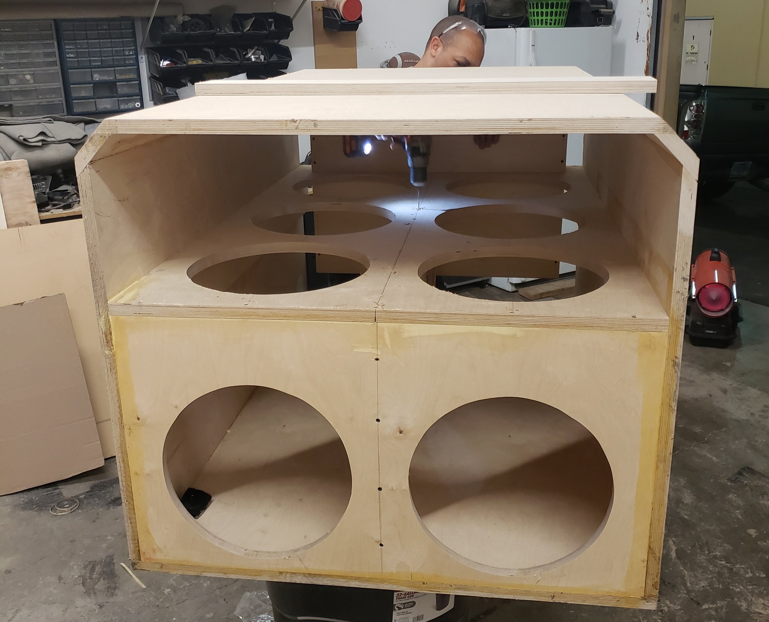

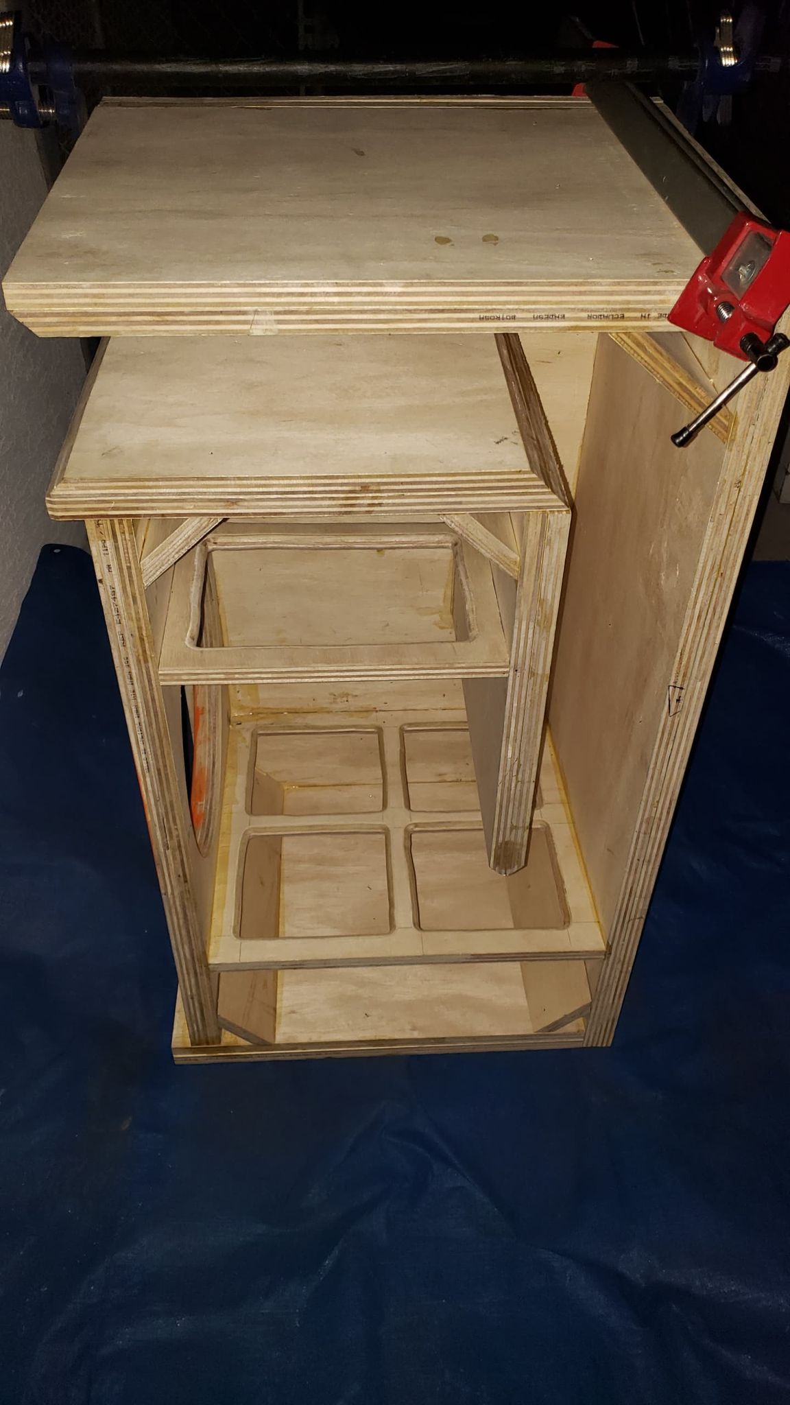

Given larger more capable subs for instance I insisted on a 2 ply triple baffled design for a single Zv5-15... on 5K... Sanded pine...
27008
Or nailing it with a 2py , triple baffled Russian birch design... this thing was crazy I was told.
27009
27010

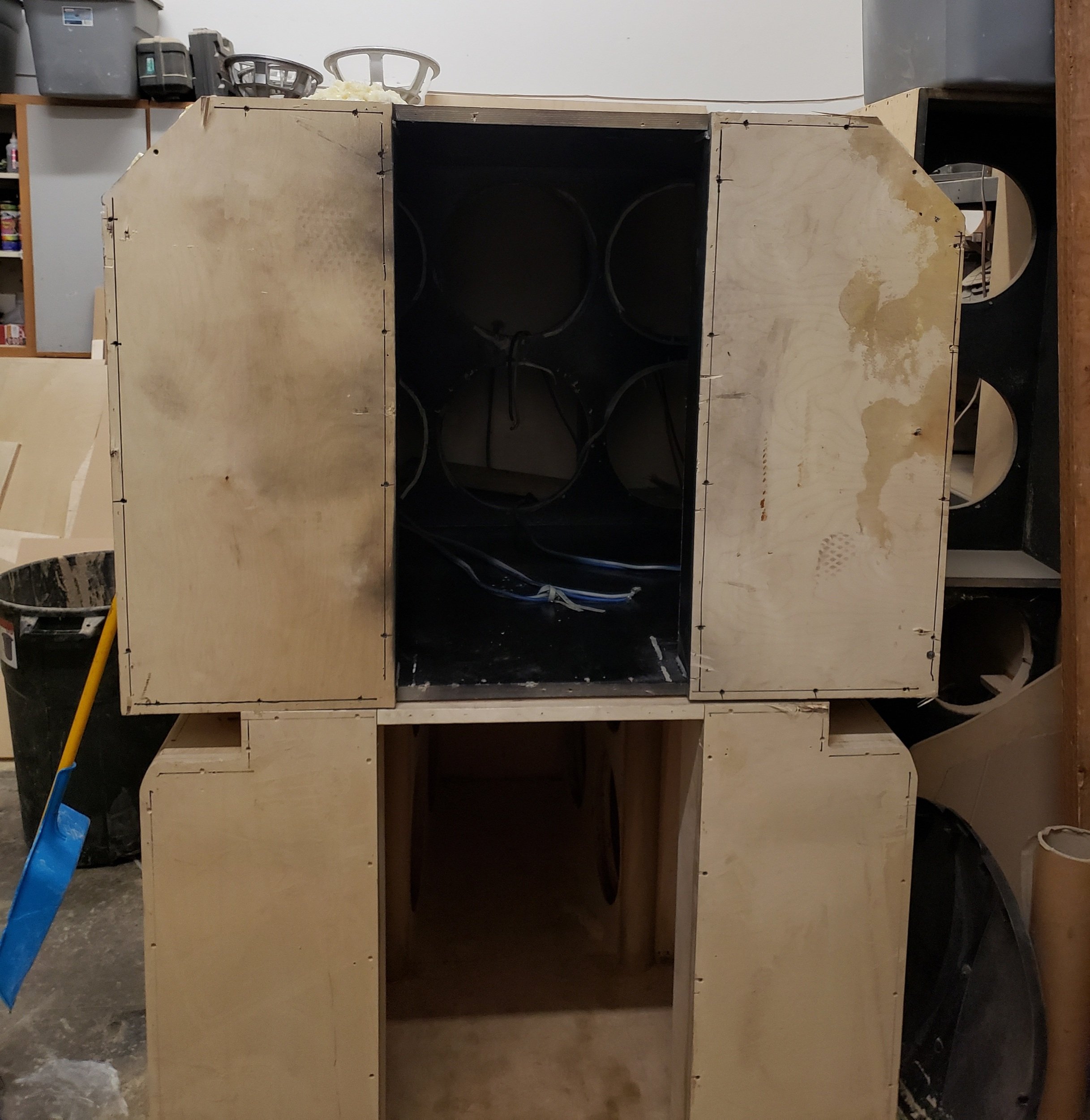

Materials go out the window once you go 4-15's wired down on 16v.. I heard this one did 156+ out the gate on 4K clamped or so
27011
... but these guys are THOSE guys... crazy what testing can do isn't it?... I heard it was 158+ on 4K last report clamping the same... tuned 28hz this thing is peaking low... Hi voltage-low wired-dead cabin (or setup)... a pair of budget amps shouldn't put out THIS well.

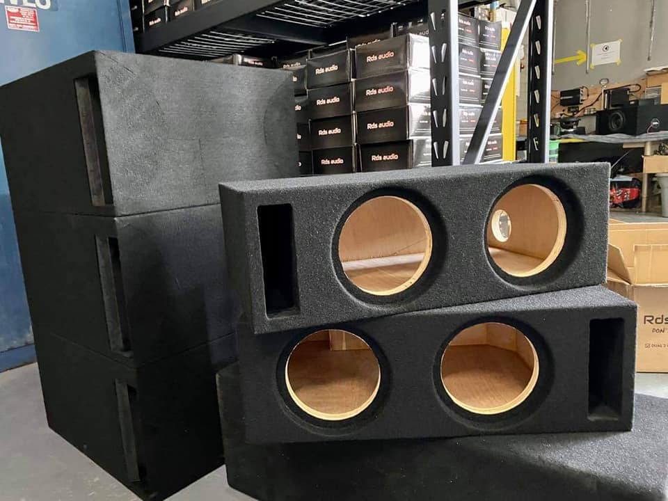

I like that Hdf

Agreed! No way would I personally do that with a single baffle even with 1" birch like that with 8 15" subwoofers regardless of the brand. Has to be more to that design.
Believe me, he braced it plenty. 17 layer 1" is strong AF. Just like these other two.
That's a single ply enclosure? Just me but I hate the 2 subs off plane... its like trying to stuff subs in a smallish space requirement.
I seen this posted once or twice before... How about the install man?
There's NO way that's the end result
You can't see all of the bracing that was done.
