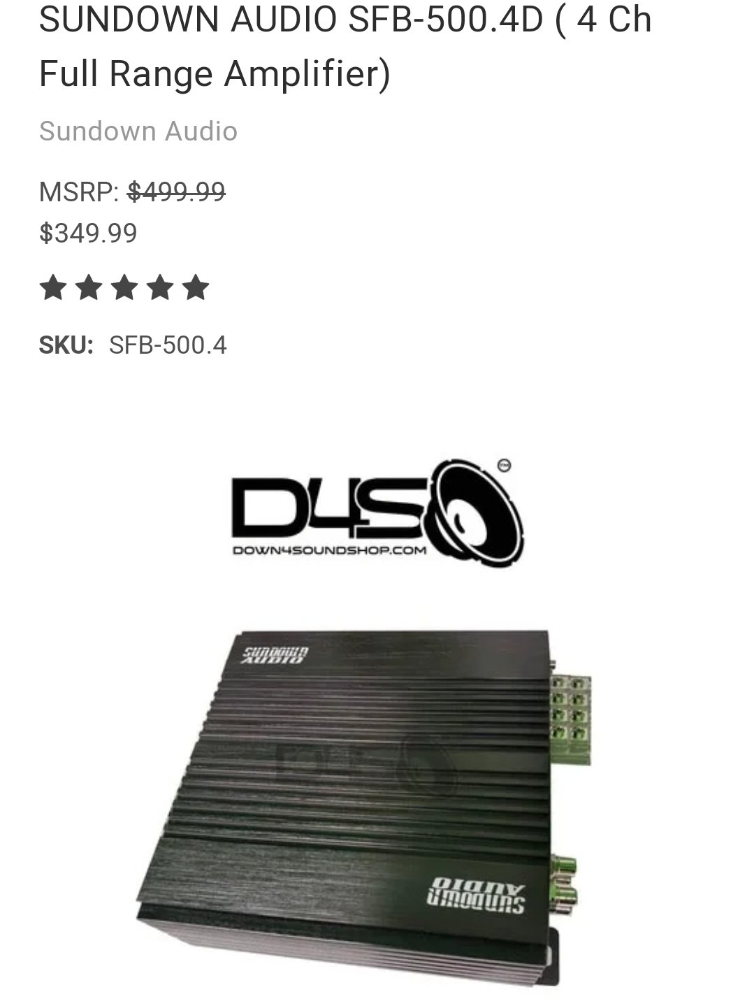

Maybe, delete the 6"x9"'s and that mono amp and get this amp.
So this is where I get a little fuzzy. If i get a 4 way amp like that, won't I need to get component speakers that are capable of 500w rms?
I don't get how using a 4 channel amp for 2x component speakers and a sub works. If you've got a 500w x4 amp, the idea is you bridge 2 channels for the sub and send the other 2 channels to the components right? Wouldnt that destroy your component speakers?

you can run a 500 watt amp to 100 watt speakers, if you set the amp gain right. heres how. the test tones are at the very bottom...

A 5 channel amp will be pricey. Get a four channel and run two channel s to the components and the other two to the the sub. If you keep the 6"x9"'s then run them off the deck.
