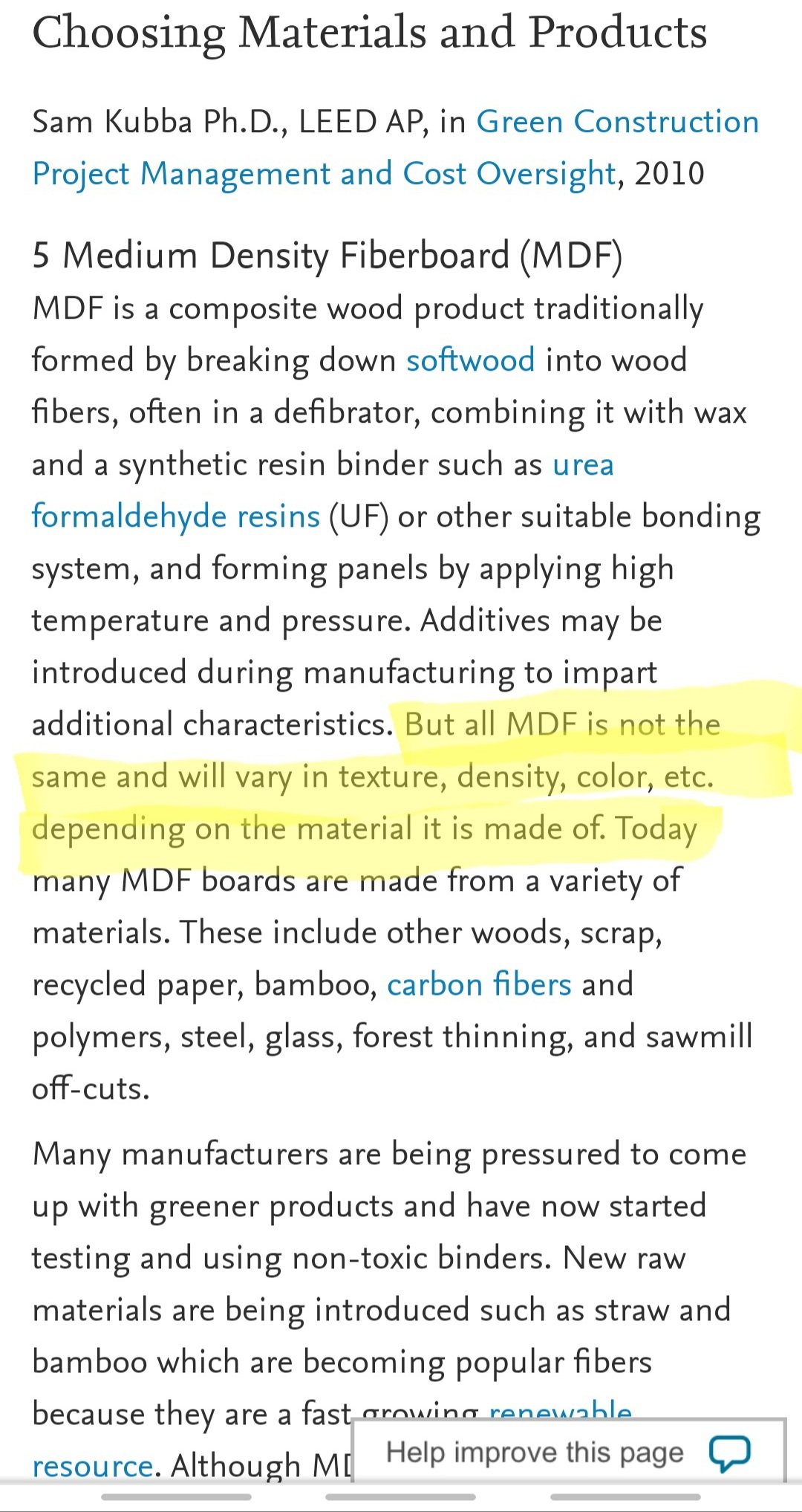

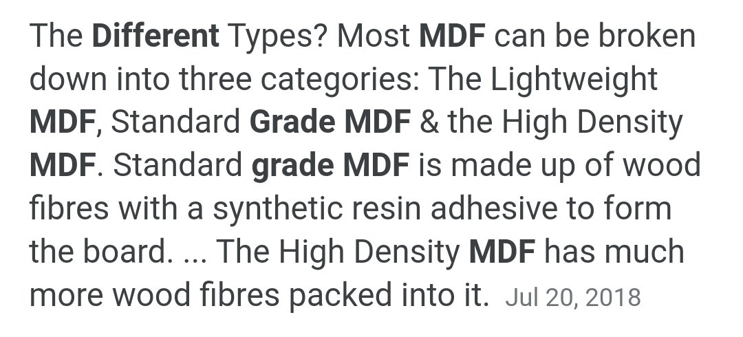

That's like you saying all Birch is the same, or, all 2'x4"'s are the same, they aren't. Obviously, the denser the MDF, the better. Some MDF will even start flaking off in layers. Buy whatever you want, just know that all MDF's aren't created equal.
That's a big list of binders, can you show me an ingredient list that shows the difference between binders used by home depot and these luxury lumber yards?

Use whatever type of MDF that you want to. Just know that they aren't all the same. It's common sense that the denser the MDF, then, it will be stronger and have less flex. But, like I said, use what you want.

You just keep buying the low grade MDF. My lumber told me today that he carries about 7 different grades of MDF. Denser = stiffer = less flex. I don't have time to do all of this testing that you are talking about. It's common sense. We het the best grade ¾" MDF for $34 a sheet.
