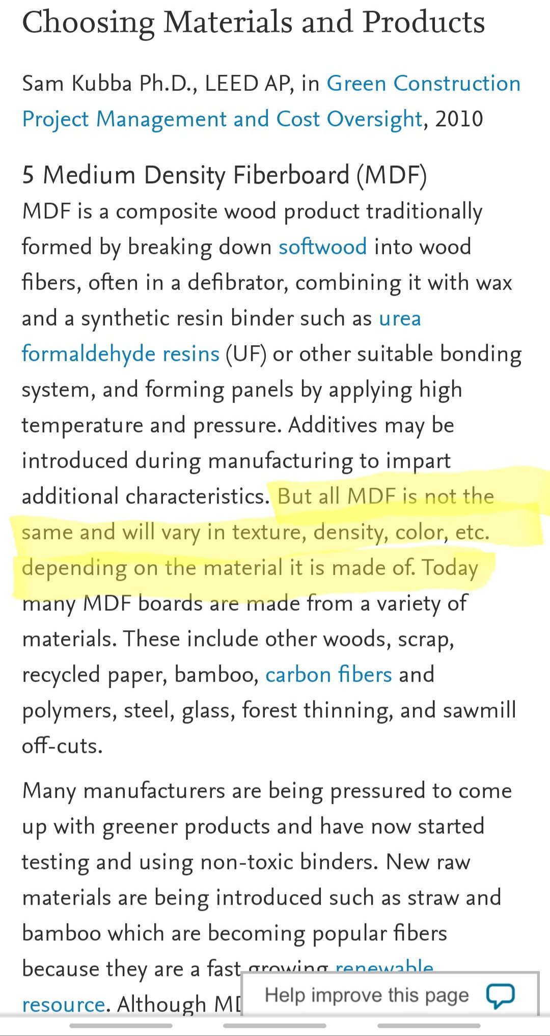

what’s considered “good MDF”, any High Density MDF?
aside from cuts, do you have to paint or epoxy/etc the MDF for structural strength or use as is?

Mdf is just mdf. You don't need to paint it for strength, but make sure it doesn't get wet.
Wrong!
