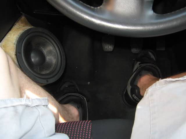

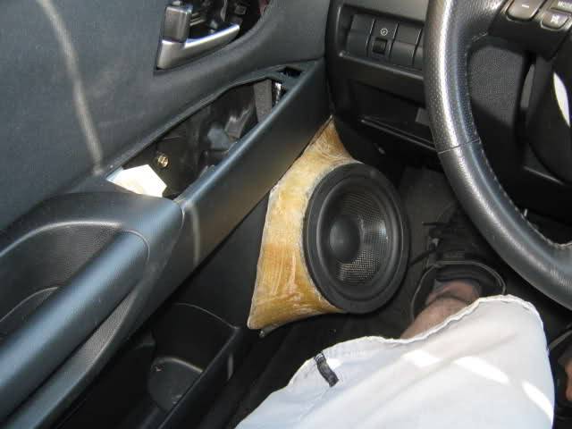

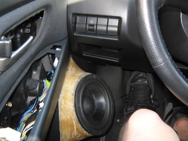

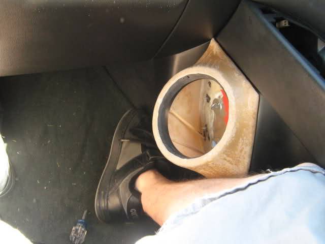

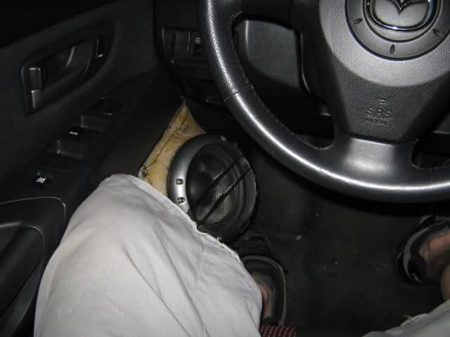

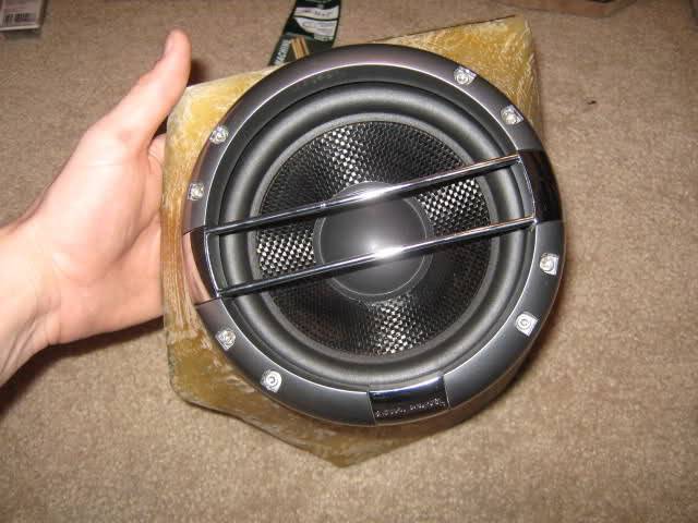

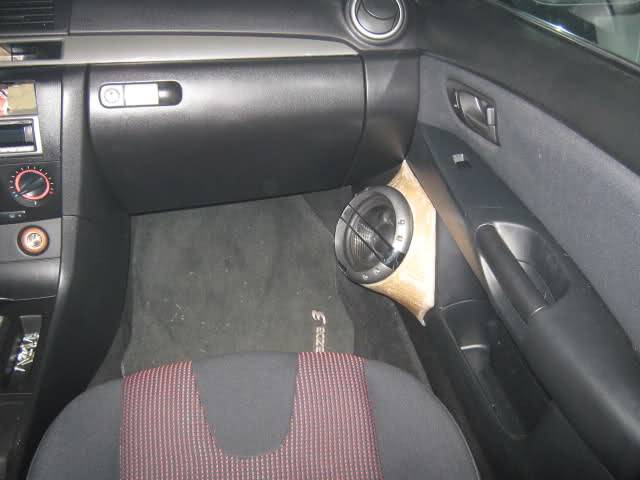

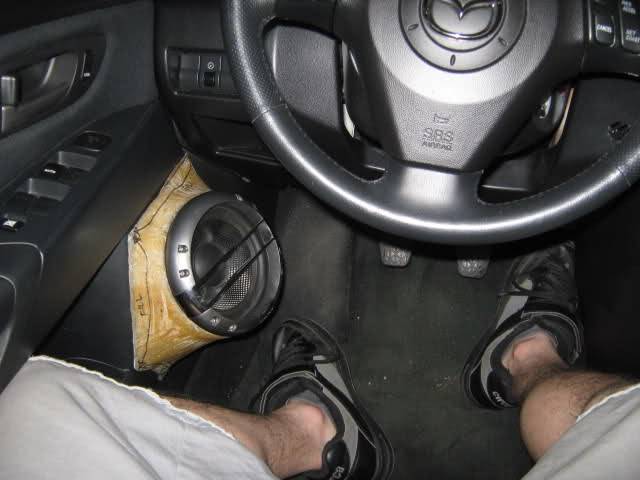

I'd like to see a mockup of just how far out the pods will stick?
i have some pictures coming shortly, the only problem is that its raining and i dont have a garage so doing anything really sucks.... i hate the rain
i had to use my leg to hold it up, to lazy to take the panel off and mount it using some tape or something

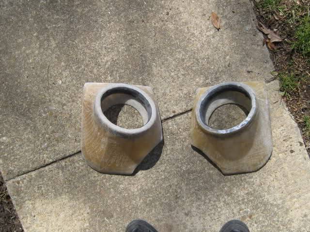

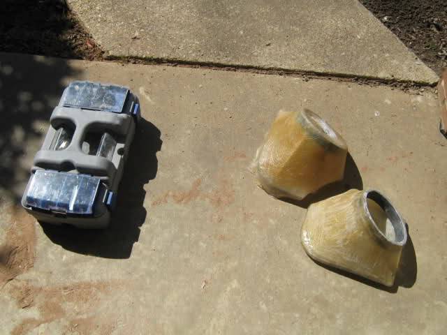

ok so the weather has finally started to work with me...

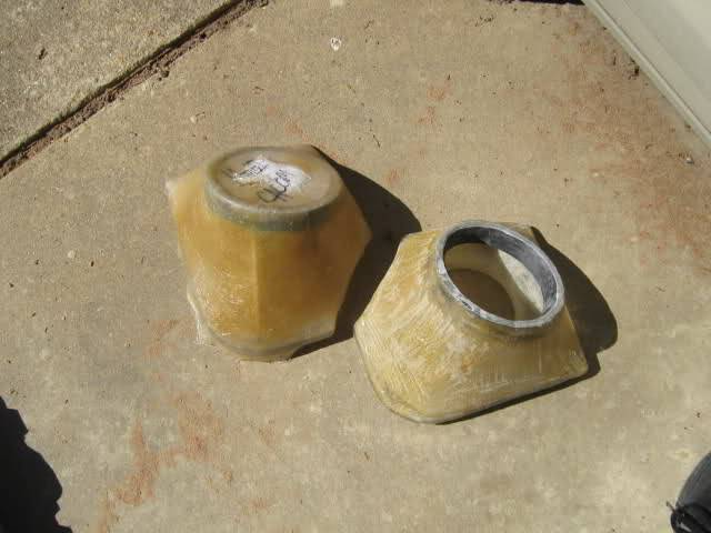

got the first one glassed this morning and cut to fit
still have to do a lot of sanding before i can put some bondo on it but heres where im at right now
after the second one... still drying

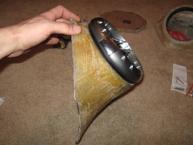

ok so my retarded a** did not think about mounting these to my door before mounting and wrapping them with glass... sooooo i had to put some thought into it
but i guess thats what happens when you do this kinda stuff by your self right...

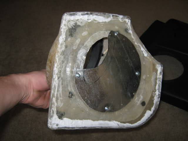

ok, so i have been really looking into how i am going to mount these to my doors... as i already said i didnt pay any attention to how i was going to do it... also not realizing that the big whole that i made in the middle of the base is a little bigger than i need it to be for mounting the wood onto the pod...
the idea that i have now is that im going to use the oval pieces to mount to the door than the round ones to mount to the pod that way i i will have to remove the pods in order to take off my door panels, that will also help to pull the pods tight up against the panels and have less chances for rattling... using some single sided foam tape around the back of the base will also help in reducing any noise that may be created from the pod rattling against the panel

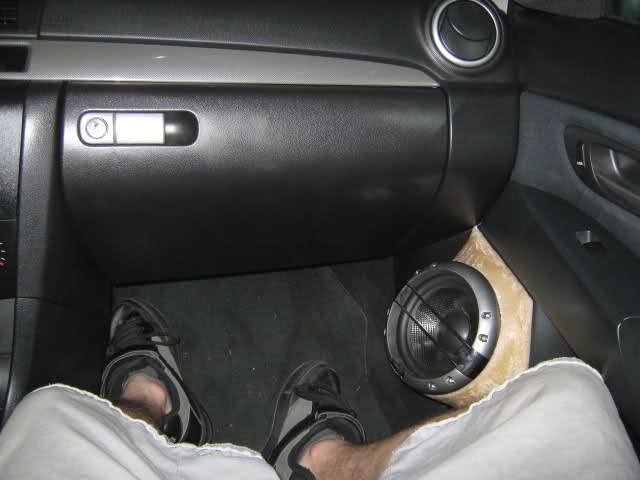

just finished sanding down the left pod... on the way to mount em... this weekend is looking a lot better for finishing this project
wow there starting to look like they belong somewhere //content.invisioncic.com/y282845/emoticons/biggrin.gif.d71a5d36fcbab170f2364c9f2e3946cb.gif

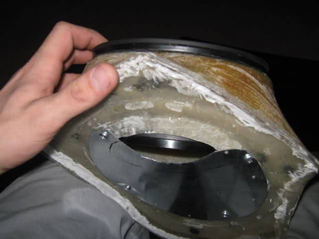

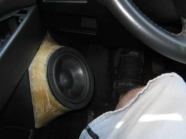

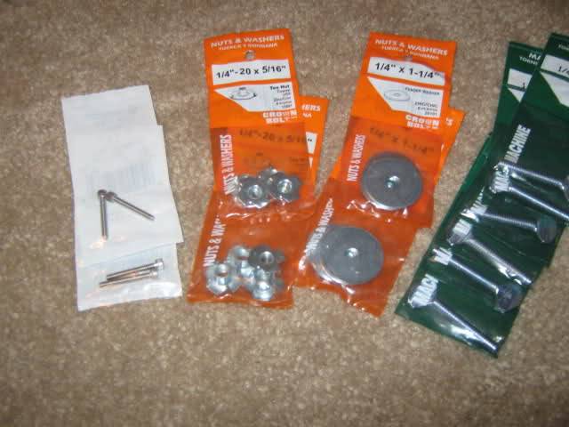

ok so after thinking to much about how i was going to mount these and consulting with req i finally got an idea of how i should mount them so here we go

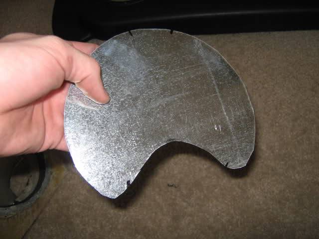

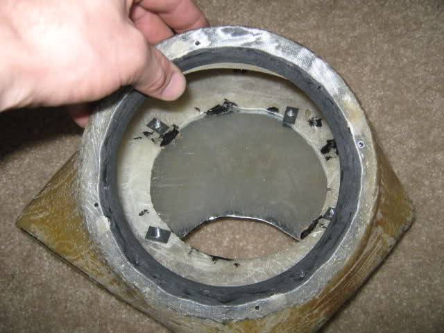

i cut out two pieces of sheet metal to mount to the back of the pod with notches in the so that the speaker does not hit the back of the pod
used the t screws and washers to mount them to the wood mounted to the panel and the anchor nuts to hold them in place... this was a pain in the a**
