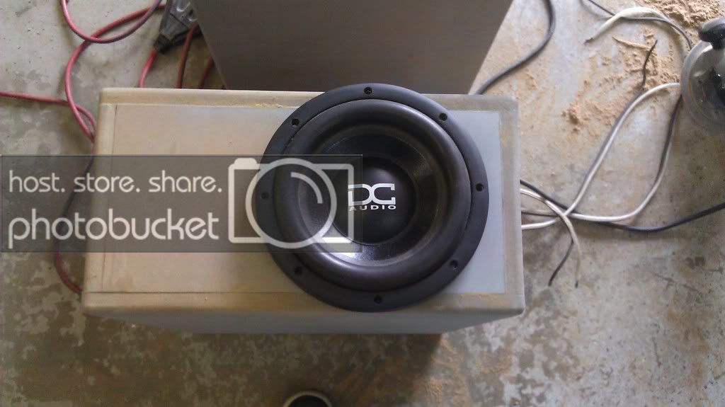

2 8" True Bass Ultra 8s

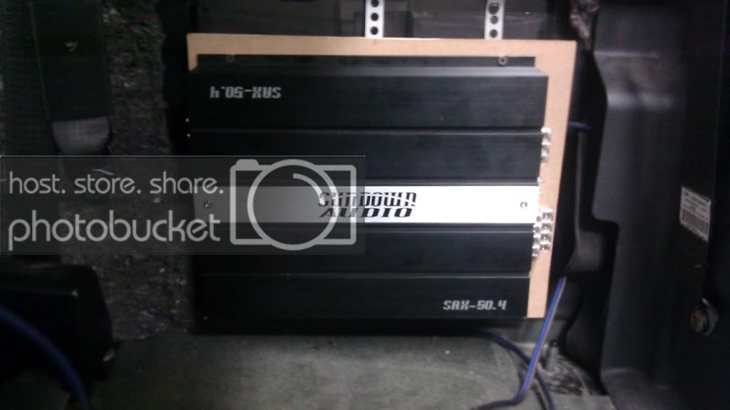

Speaker Amp
Sundown Sax 50.4
Sub Amp
Re Audio 35.1

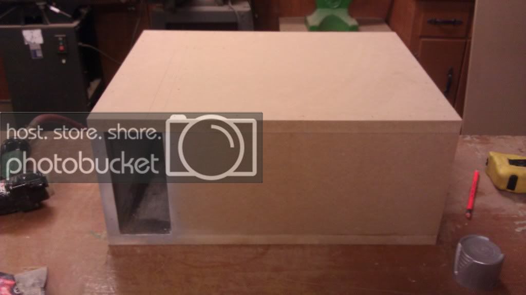

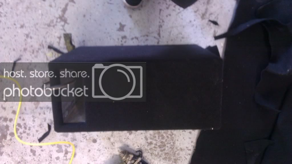

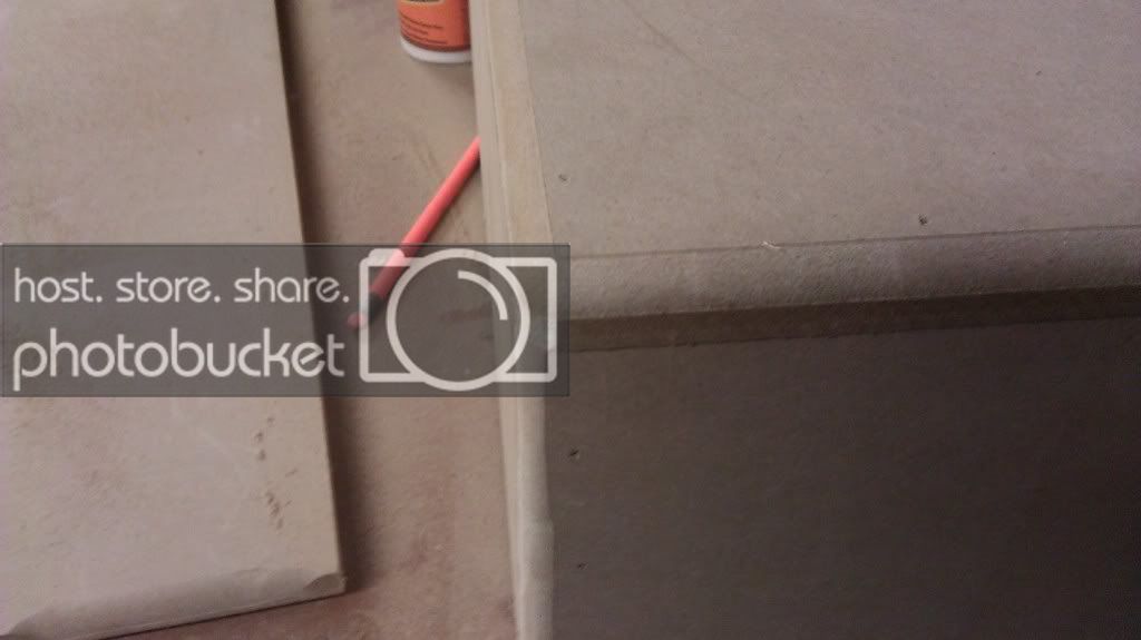

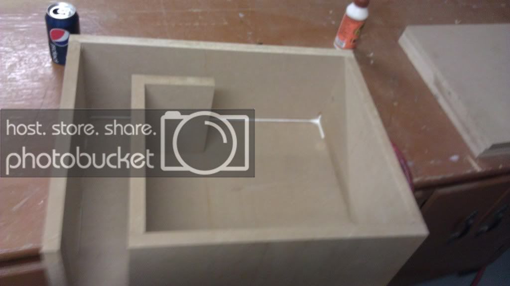

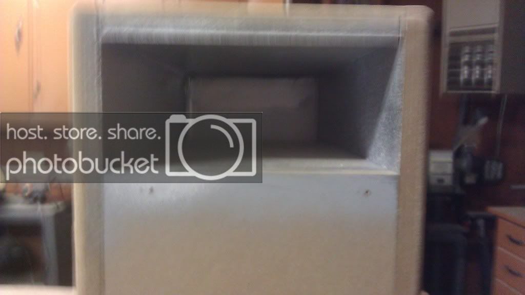

Box specs

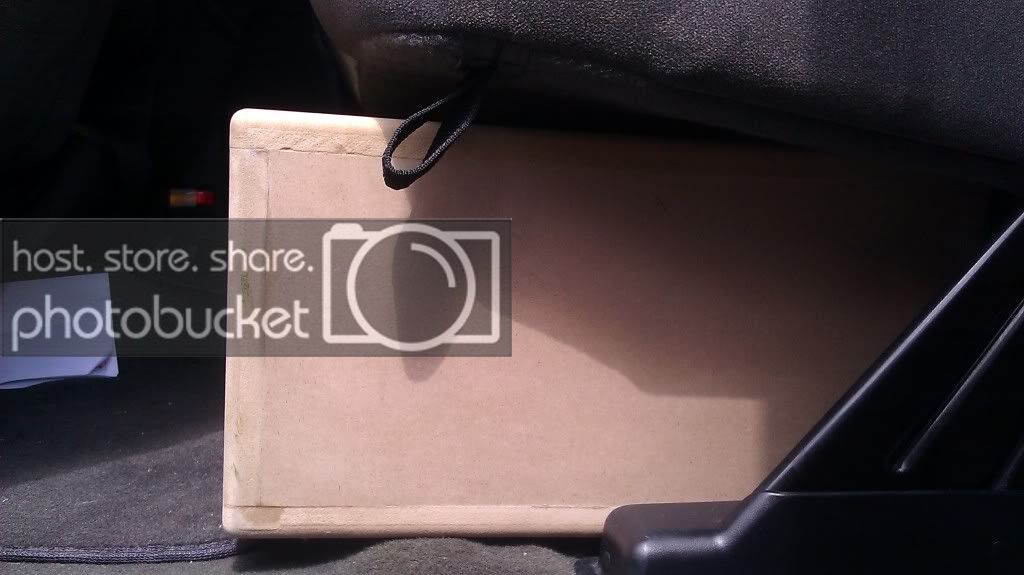

Boxs are .9 Cubic ft net Ported tuned to 36hz

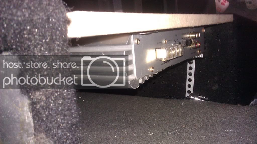

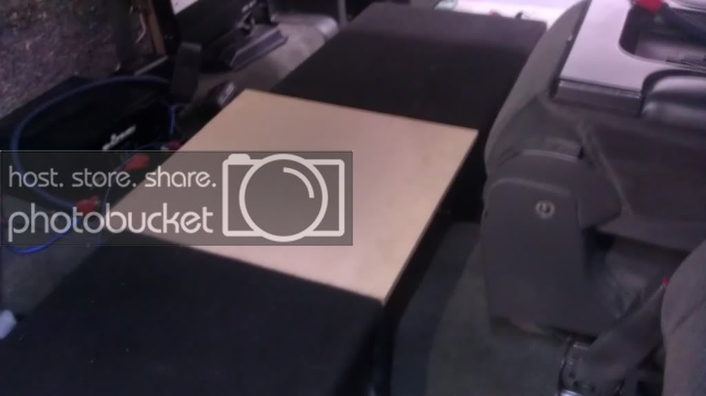

Fitting underneath the back seat
Photos up Shortly they are a not the best but hey its what i had left on my computer/phone

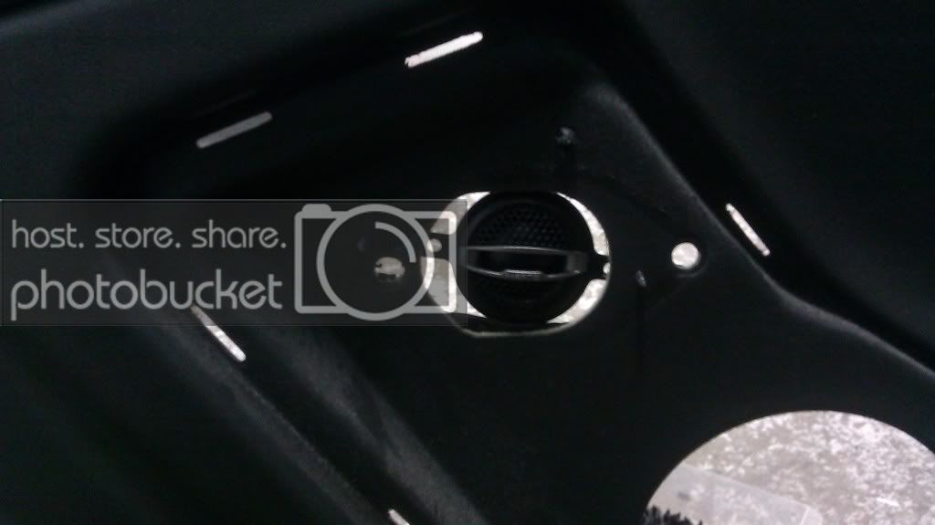

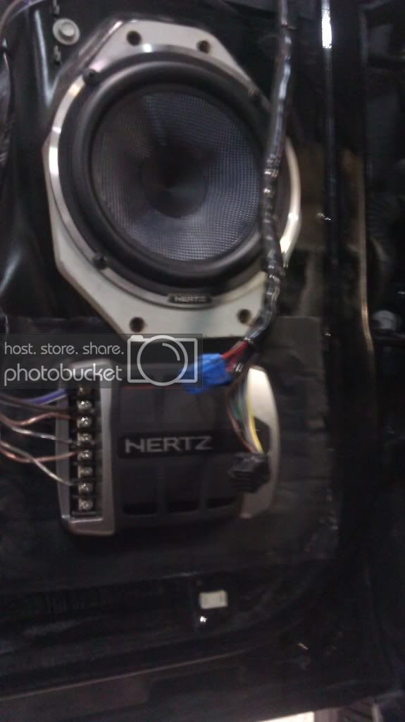

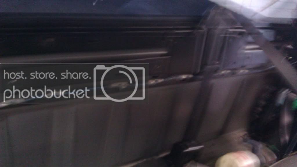

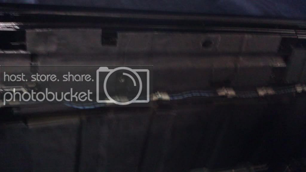

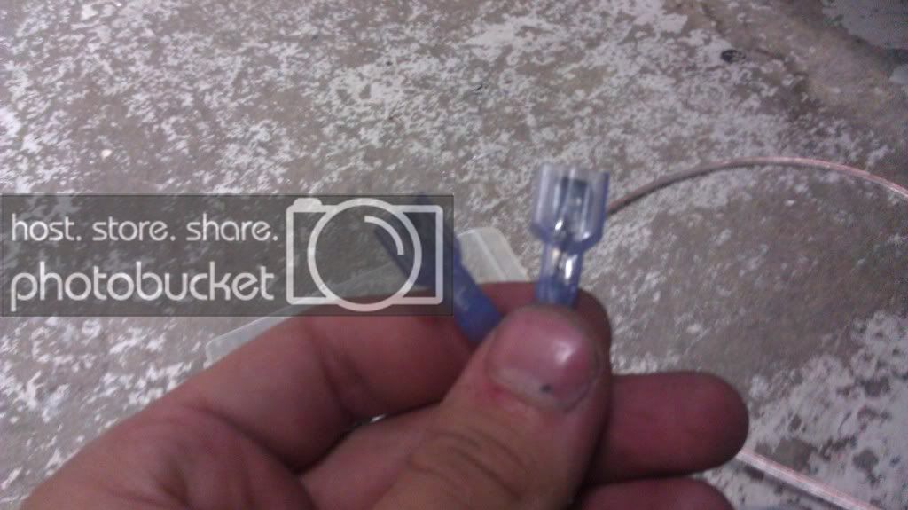

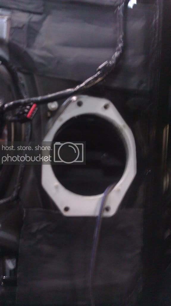

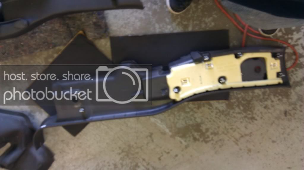

Used male and female connectors for a quick release since I put the tweeter in the door panel
This mounting is a temp situation until I glass the tweets in the pilliars and the 6.5s in the doors

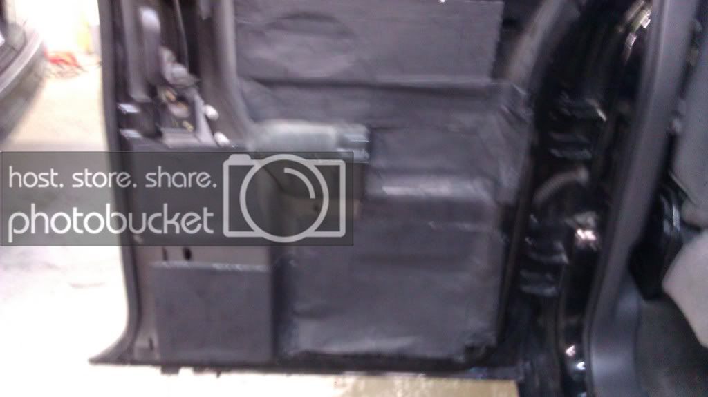

Reason for no rear stage was the doors were completed sealed up because the subs would be loading off the doors
---------- Post added at 12:52 PM ---------- Previous post was at 12:52 PM ----------
And yah i know its hard the see but that is the black second skin
