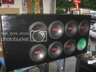

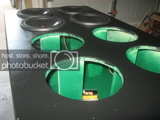

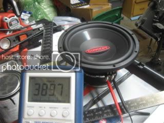

new subs and box for the heck of it. Will be doing sb3 at the heatwave.

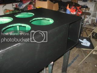

hooked it up to a crossfire cfa202 at 1 ohm stereo and even with one sub just floppin' and a total rated power of 200 watts to all 7, it sounds like it will be loud. The specs on the box are 8.7 net tuned to 35Hz with 127 inches of port. port fires up and will be drivers side. Box is designed to fit right on the back seat though it may end up on the floor if it meters higher that way.
