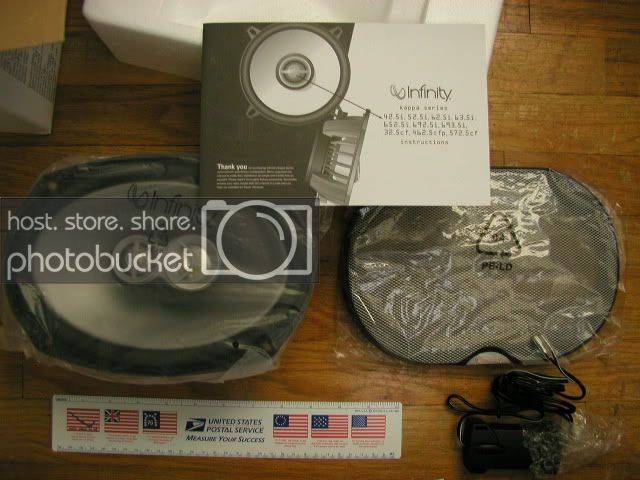

ok, found the Infinity pics, here they are:
Fronts: Kappa Perfects 5.i's
Rear: Kappa 693.5's

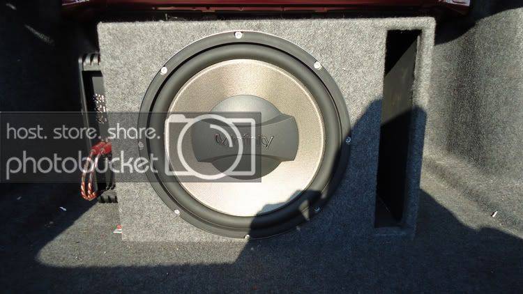

but anyway, here are the pics of the subwoofer install,
i brought the stuff not knowing about the ohms 4 or 5 years ago, but heres the specs
Infinity switch 2ohm or 8ohm, 12 inch sub - 350RMS, 1400 peak

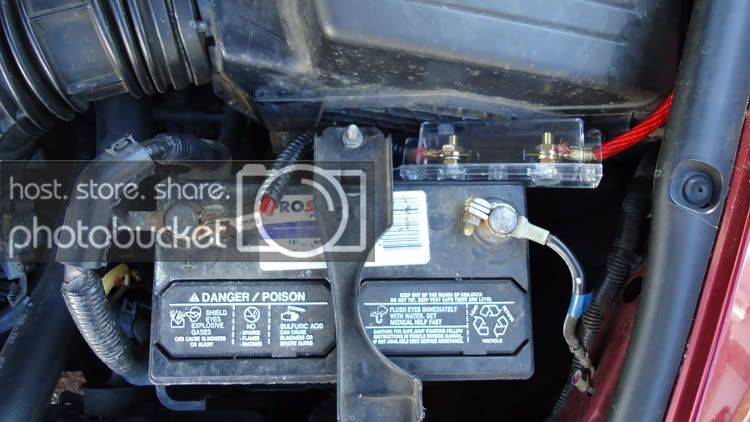

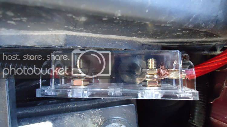

Battery and Fuse:
closeup of fuse:

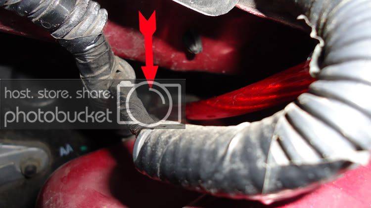

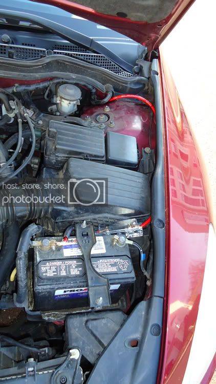

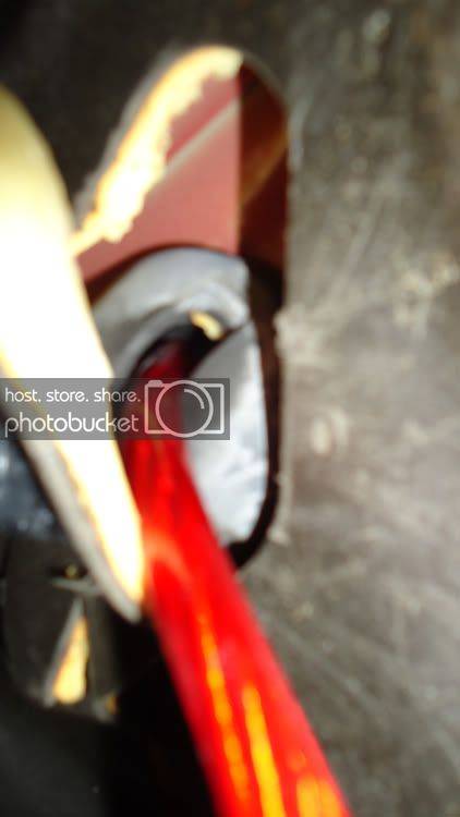

right side engine bay, follow the red 4 gauge
4 gauge through factory rubber gromet (tip of arrow), had to poke a hole with a screwdriver from under the dash

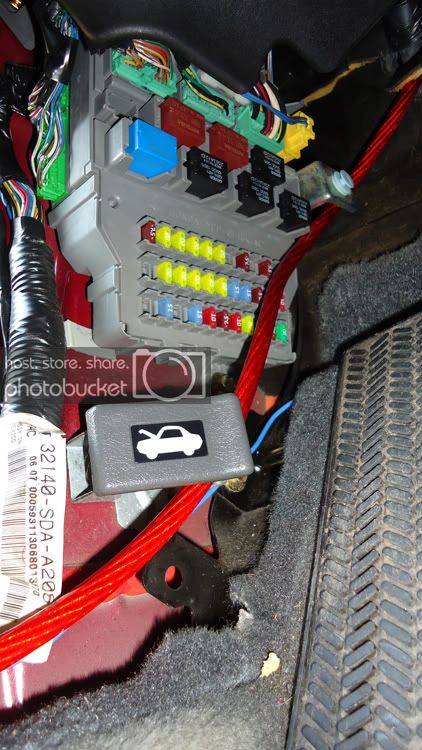

4 gauge coming through rubber gromet to deep up under, behind the dash:

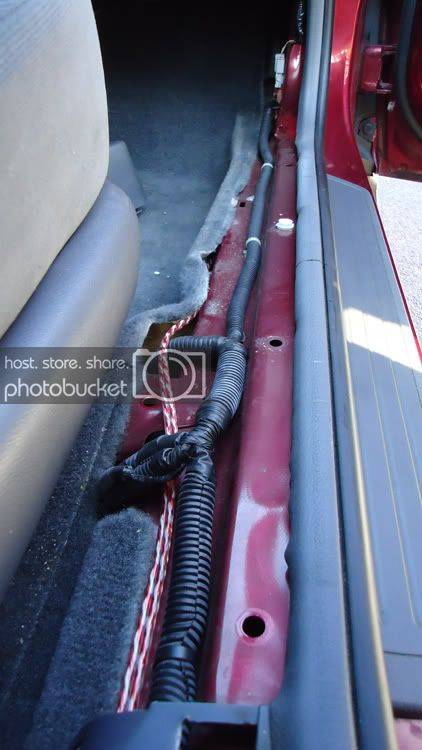

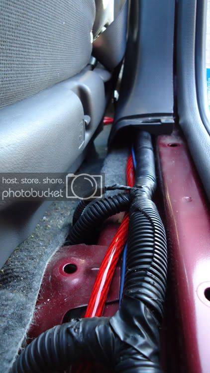

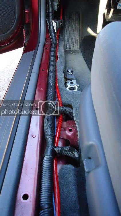

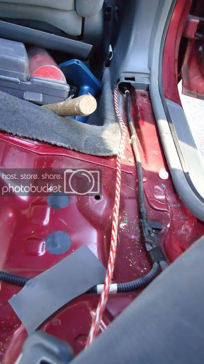

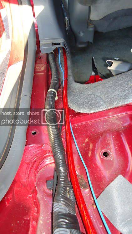

Following down driver side of car:

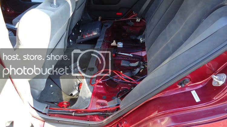

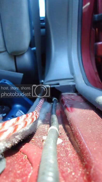

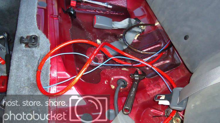

rear seat removed, 4 gauge running to trunk from under driver side seatbelt panel:
Passenger side, front of car for speaker cable:
Passenger side, through and under seatbelt panel:

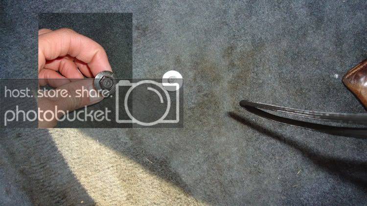

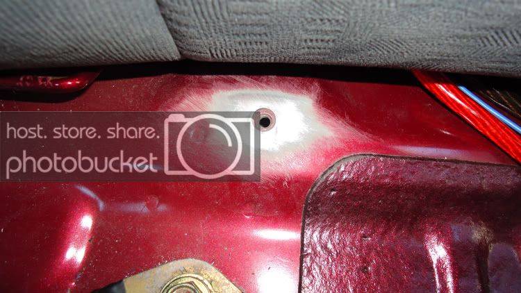

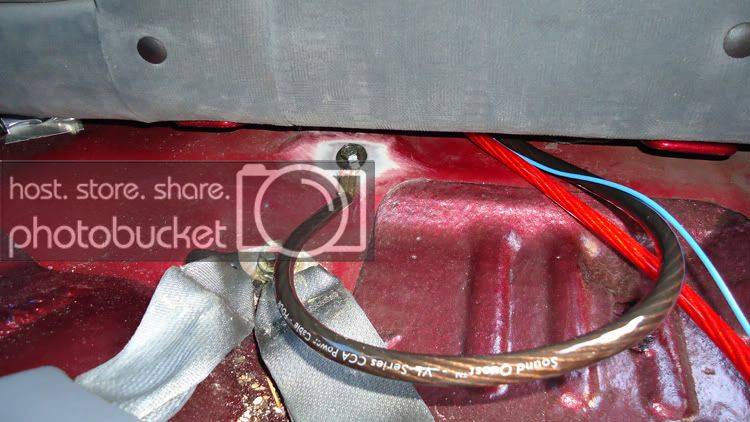

Negative location (rear seat bolt) sanded down to bare metal and sanded bolt:

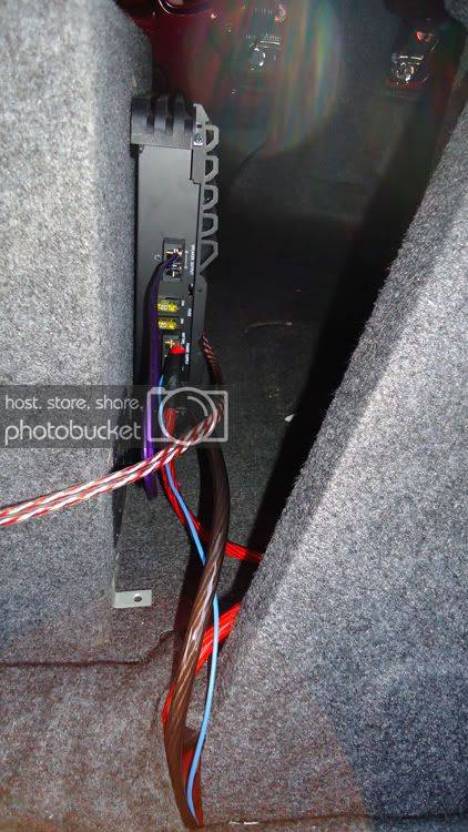

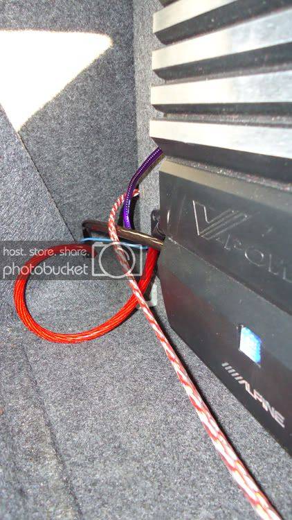

rear view connections
front view connections
Last but not least.... Finished product

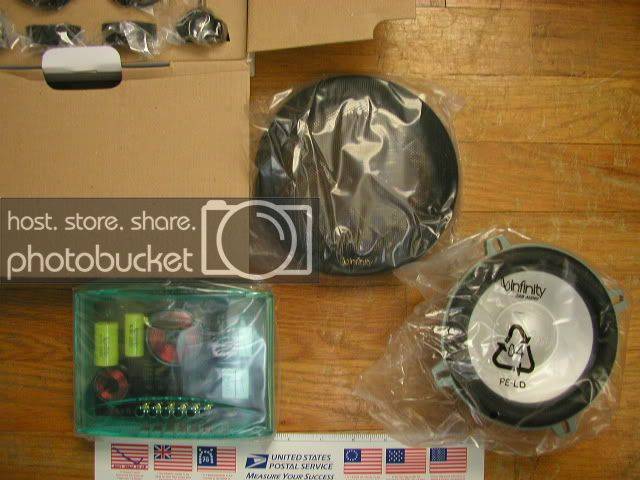

Ok, here is a quick update. Big ups to my man with the hookup. Instead of those Alphasonik's I was looking at, I decided to go with what I know best... Infinity!!!. Just got the 60.9s for the front stage of vehicle.//content.invisioncic.com/y282845/emoticons/yumyum.gif.0556df42231b304b9c995aefd13928a8.gif i may run them on a used and old Sony Xplod xm-552hx... (which is hella lame), I may even ditch it period and run the speakers off stock wiring, dont know yet
Infinity 60.9
power range: 2-90 watts RMS (270 watts peak power)
frequency response: 45-35,000 Hz
sensitivity: 93 dB
here is the box:
look at these babies: nice

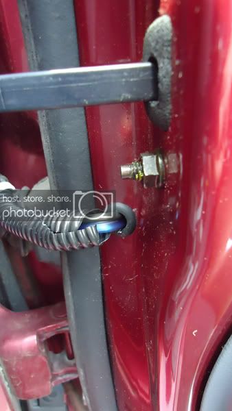

Ok, so i finally got the time to do some wiring of the front stage. Spent the past couple weeks trying to figure out how the hell to run wire to the speakers through the door. I be **** that Honda has wiring harness in between door and chassis of car. Figure, I never seen this before, nor heard f it. I couldn't get my fingers up under the instrument panel, driver side has so much wiring SH*T up under there, I spent many night researching and Googling ways to get around it. Thought maybe "jumping the factory speaker wires but then i wondered" how the hel to get wiring to the stock tweeter location. I almost gave up and was going to get the speakers professionally installed. But I'd feel hella lame doing that. Testosterone wouldn't accept it, so i came up with this so far:
Popped the door off:
[/img]
Finally got my fingers up under the dash and through the hole, since i couldn't go through the wiring harness, I go around it. I poked a hole through the rubber and ran the speaker wire outside and through the hole I made, looks pretty to me:
hole with grommet:
[/img]
Completion with Split loom around it:
[/img]

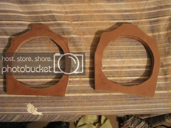

So I realized Id have to make a circular ring spacer. Went and brought 3/4 in. MDF for $11 at Home Depot. I have dimensions of speaker, but no compass to create actual diameters on MDF board. Nor did I have a way to cut a hole. So I traced the plastic ring that cover the neoprene on woofer, figure its a good template. But I have no idea how to mount it. Honda has the stock 6.5B built into the mounting piece that attaches to car. So I figure I use that as a solid template. Thanks to my Uncle i got my hands on a jigsaw. And away i wen... 1st time I ever did and woodworking fabricating, I think it turned out well and hope it fits.
[/img]
Speaker fits fine...
[/img]
