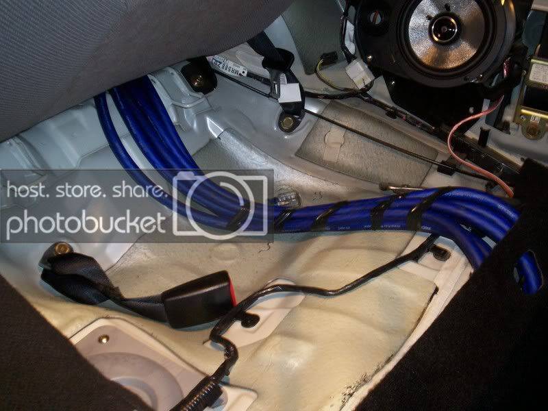

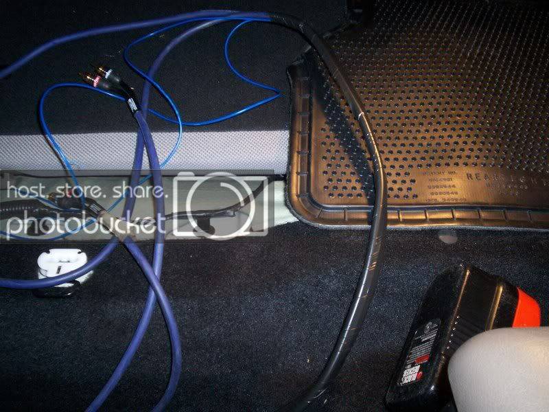

Power cable: 6 runs of 1/0 from front to back, 3+ and 3 - . All 1/0 is Kicker Hyperflex.

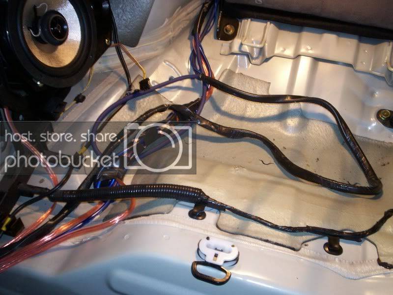

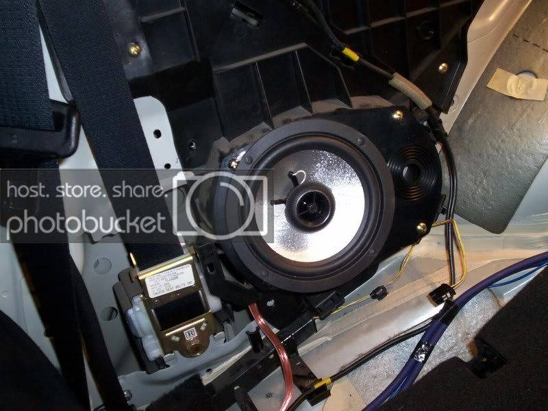

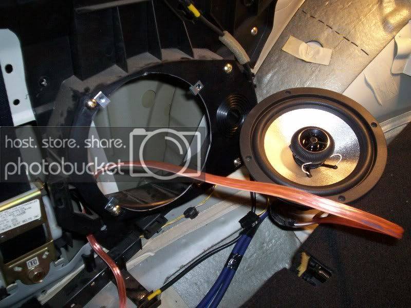

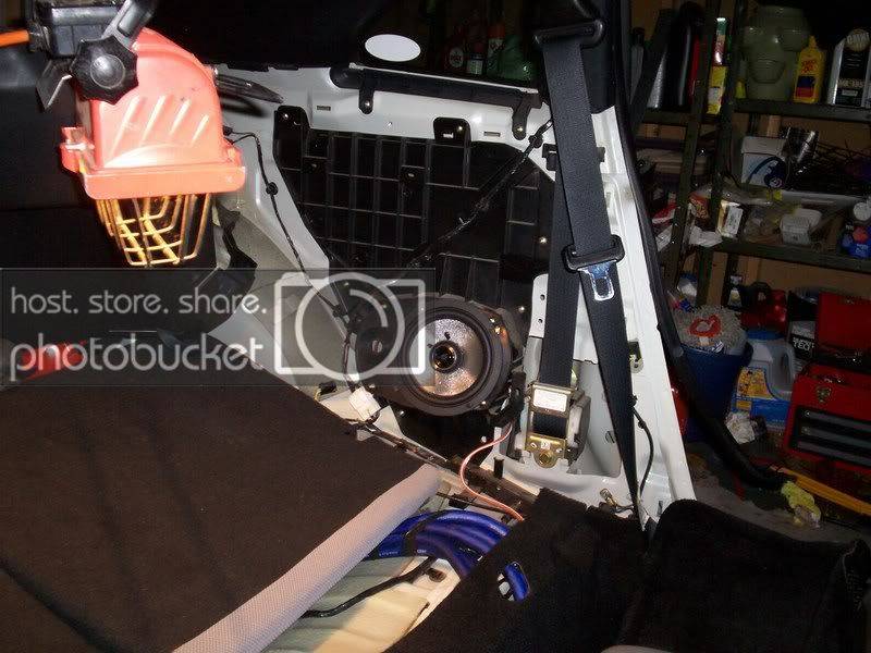

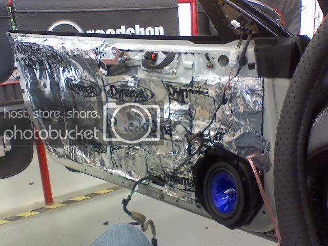

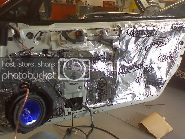

my next day off to finish the install will be monday. so far i have my component amp mounted with all wires ran up front to the crossovers, but no components in the doors yet. i have the rear speakers install, and the 6 runs of 1/0 ran from front to back. I ran new wires from the headunit for the rear speakers, and uninstalled the factory infinity amplifier. i have been keeping my wires clean and wraping in electrical tape as you can see in the pics. also, pics for the trunk have not been taking yet. Will take those monday when i finish...
was finally able to get more time to work on the car. doors are deadened and components are in finally... since the tweeters are big, they had to be installed directly into the existing tweeter pods. the existing tweeter cover was removed and tweeters were placed in a flush fit. this was done by a previous member of Team Soundstream, Maxxsonics, and Tsunami, named Joe who is the install supervisor at the CC I install at. he did a very good job and they came out perfect. will get pics of them tomorrow.
