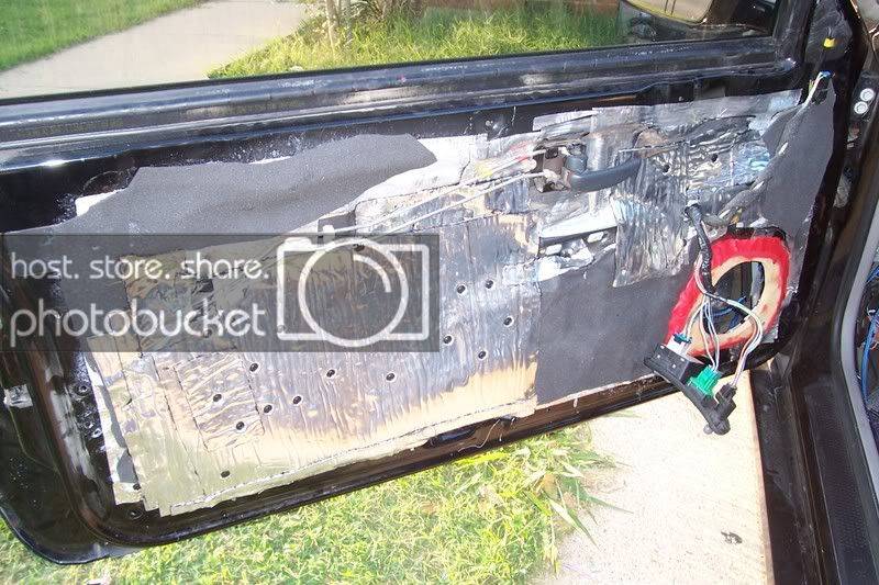

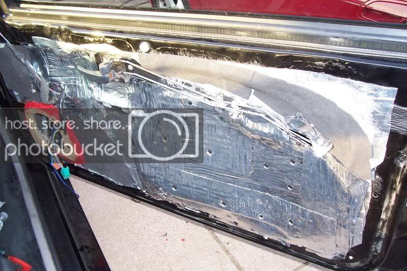

Well after about 3 hours a piece and 60 sq foot of Raammat. Also a roll of aluminum flashing to seal all the holes. Inside door 2 layers of Raam and a layer of ensolite, the 2 layers on top of aluminum and one behind.
Good thing my bro is doing it, I dont have the patience or the time
why not ensolite over the whole door, and just in spots?
I got tired. As you can see they arent totally finished and what you see on the outside was from previous. It will be done probably tomorrow when I finish the tweeter pods.
But ensolite is on the entire outer skin as well.
