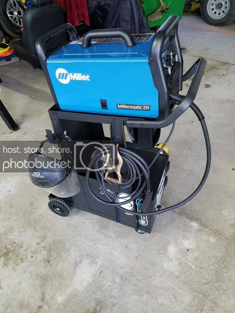

In other news my welder came a day early and I picked up the steel for the cage today. It*wasn't very fun unloading 600 pounds of steel by myself but I managed. Welder is just sitting on the cart hoping to have gas by Thursday and have everything welded by the weekend depending on the weather.

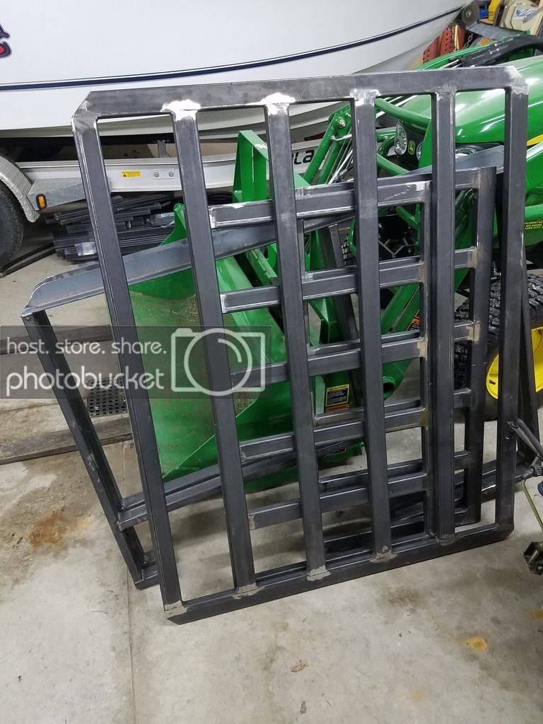

Well I've been slowly plugging away at this, doing the work by myself makes it pretty slow. These are the sides, most of the floor and the top they aren't done but it's just a teaser. Went and picked up some subs today 6 15's is all I'm going to say for now lol. Hopefully I can get this wrapped up in the next couple days as far as all the welding goes. More pictures to come, if anyone wants some neo motors they're for sale on Facebook.
Well I made more progress today cut 103 short pieces to make the grids for the sides top and floor pieces. I tacked all of them in place, put down enough tack welds to sunburn my face *So I have to finish welding all that I have so far tomorrow then grind the sides that the wood sits on. It's painfully tedious work. Then once I get all this in I have to do 45's to connect the two sections of floor. The back of the cage I'm going to try and build out farther it will have to 45 down from the top and then 90 to the floor we shall see.

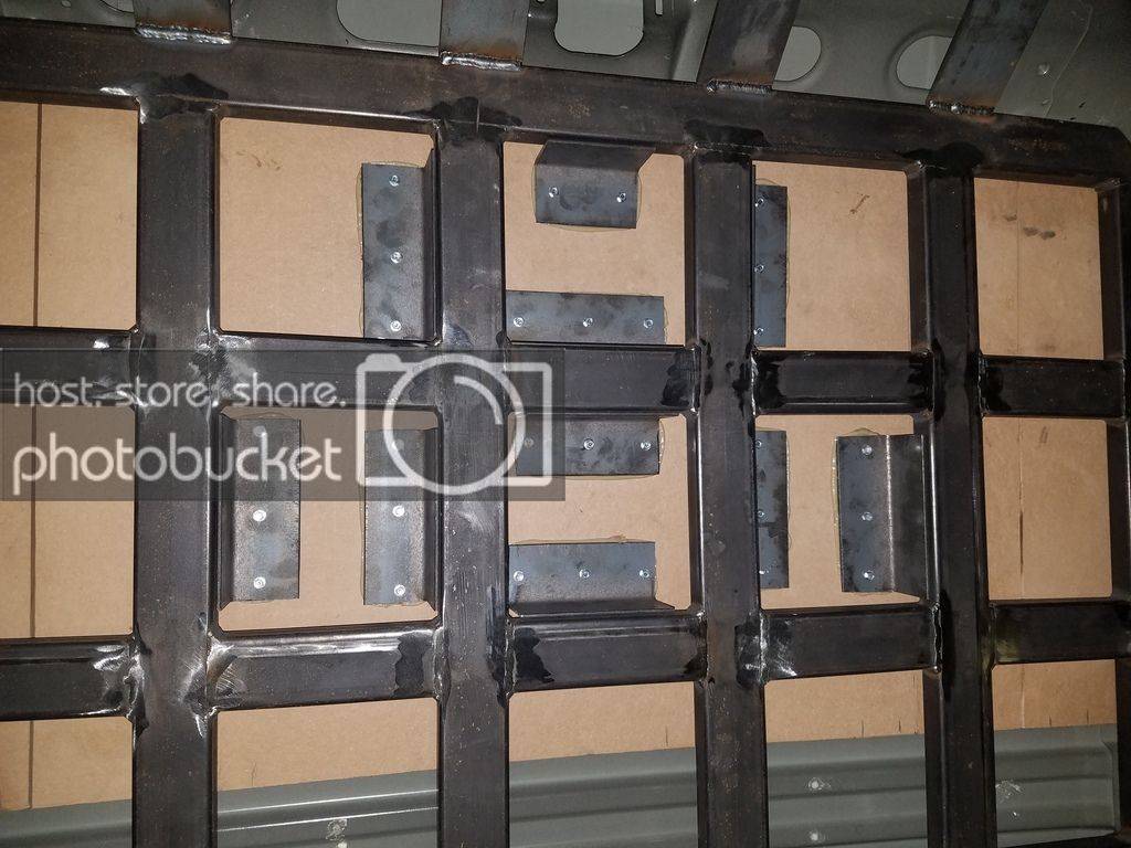

Phase two of todays project included some more bracing for the roof this is the overkill I was referring to. I cut all these pieces of angle iron and drilled 3 holes in each piece. Then I put some PL Premium on each piece and attached them to the wood on the roof. Afterwards I tacked them to the cage, I will weld them on tomorrow after the PL has had some more time to cure.
I guarantee that I didn't need this many pieces I had a hard time using them all. The placement on the roof looks random but it's basically wherever I could put them that gave me room to weld but where they didn't stick below the bottom of the cage roof. I can jump on the roof behind the B-Pillar anywhere and nothing moves at all, stupid solid.
