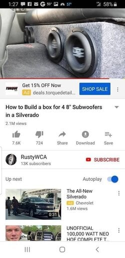

Friend of mine has a newer Chevy Quad Cab and is wanting to add subs, told him to find a place that would do this with 2-4 8" or 2 10" subwoofers depending on how much room he has with the subs facing forward like it is in this pic. Told him this is the type of idea he would want to do in a custom box. He lives south of Chicago and said 2 shops tried to tell him "oh just face them up it won't make a difference in sound". He walked right out of both because even he knew it was a waste of time to even try to attempt it.
I've tried sealed down fire I've tried ported up fire. Finally built a front fire passenger side port (delayed this because of the issue of only having 8.5 inches of height building other boxes etc.) it's night and day difference.
