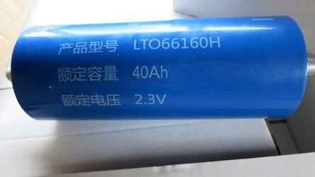

This is a thread for progress and results of the LTO battery banks I'm going to be building for my Jeep and my brother's Civic.

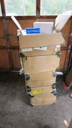

So far so good.  It was pretty scary sending a bunch of money to China but the cells arrived and the fella at the company was very helpful and on the ball with updates of order status.  Everything arrived well packed and seemingly in good condition.  I'm ordering some copper bar today and will hopefully get to building bus bars early next week or whenever my brother can get up here to help out for a day or two.
How much did you pay per cell and how many did you have to buy.
Price is low 20$ range plus shipping.  I paid for sea shipping which saved a fair bit of money but it's still pretty expensive.  If you don't mind paying more you can get them delivered in about a week (mine were about 7-8 weeks from payment to delivery).  I bought 84 pieces, different sellers probably have different minimum order quantity.
I'm guessing 40.
That's roughly the price with express shipping or the price to buy them from sellers who ship from USA.
Awwwwwwesome. Very glad to hear that everything was legit. Even used protective corners on the boxes. The cells are a little bigger than I expected, but 40Ah!
