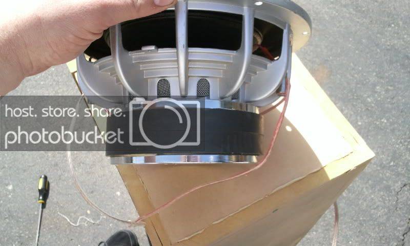

Post pics of the ass. We cant tell much at all from just pics of the cone.
ok i was wrong its a 2 stack mag, guess the version next to it was the 3stack and didnt notice when putting it in.

haha i didnt even notice the crack in the MDF //content.invisioncic.com/y282845/emoticons/frown.gif.a3531fa0534503350665a1e957861287.gif gata fill that up
Look at those tinsels. They are almost certainly slapping and getting another one probably won't solve your issue. You could throw some felt pads on the backside of the cone to muffle the noise a bit
