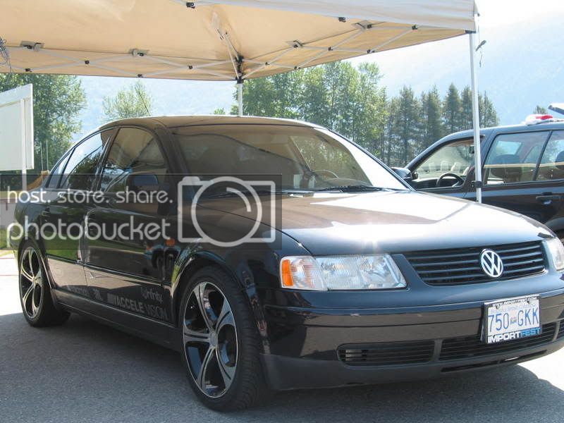

Oh, and yea that install is in a Passat.

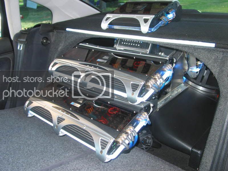

thats a real clean looking install in that trunk. real nice.
i thought it was pretty decent
that's a decent looking install....
is that a track to slide the bottom BPX in and out with????
I'll be mounting my amps inverted on the ceiling above
the rear seat when I get some spare time and there are
a few cosmetic improvements to be added
it's fun installing this shit....keeps me out of trouble:D

I know nothing about that install, but yes clearly those are tracks for sliding the amps in and out with. If you look you can see they are actually slid out, in a position that would otherwise making folding the back seat up impossible.
I think I would have tried hiding those tracks. Beautiful install, just sayin...
Oh and if you are planning on running your amps inverted, keep in mind that generally hurts their ability to cool properly. Depending on whichs amps you are using, that may or may not be an issue. If its not a fan cooled amp, dont even think about it. //content.invisioncic.com/y282845/emoticons/wink.gif.608e3ea05f1a9f98611af0861652f8fb.gif
