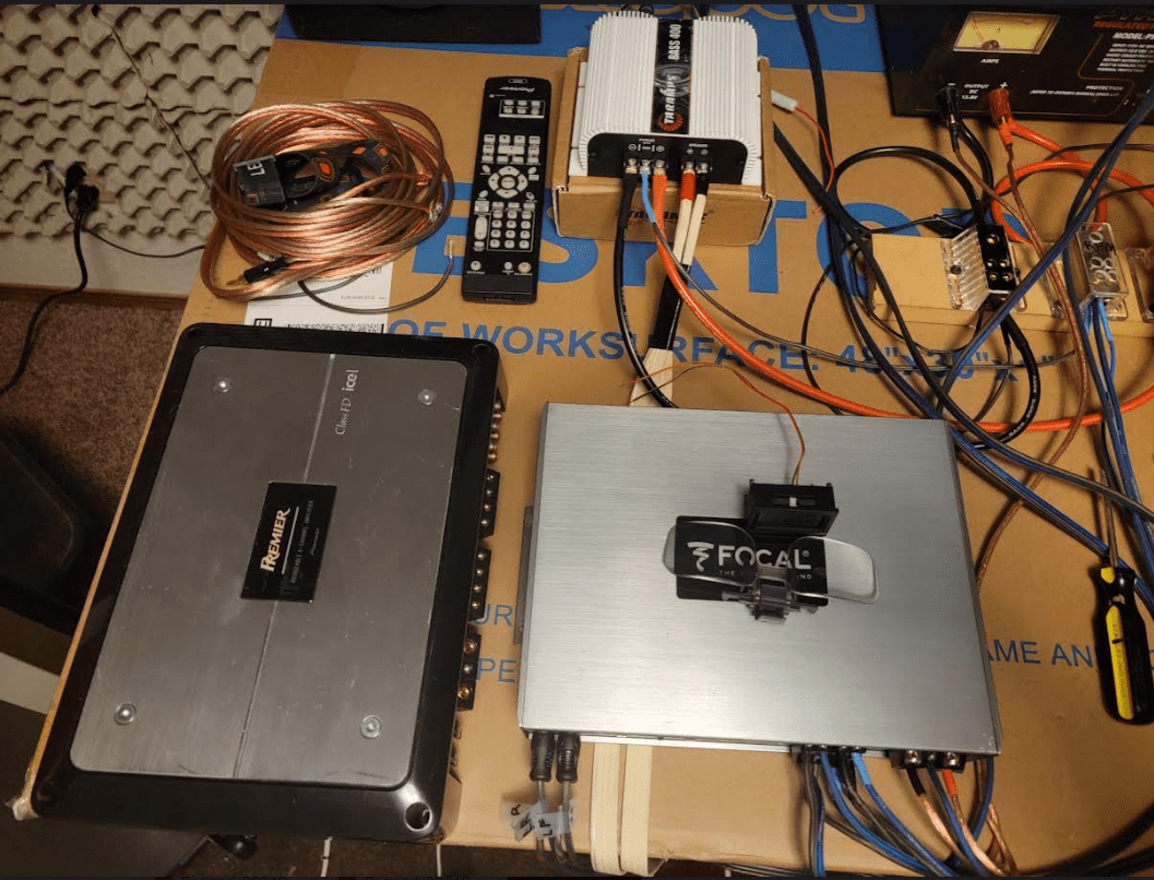

For the record, I own the BASS400 Taramps, use it on my testbed (see at top of picture). Nice little amp but I also have a constant 13.9 voltage feed.
