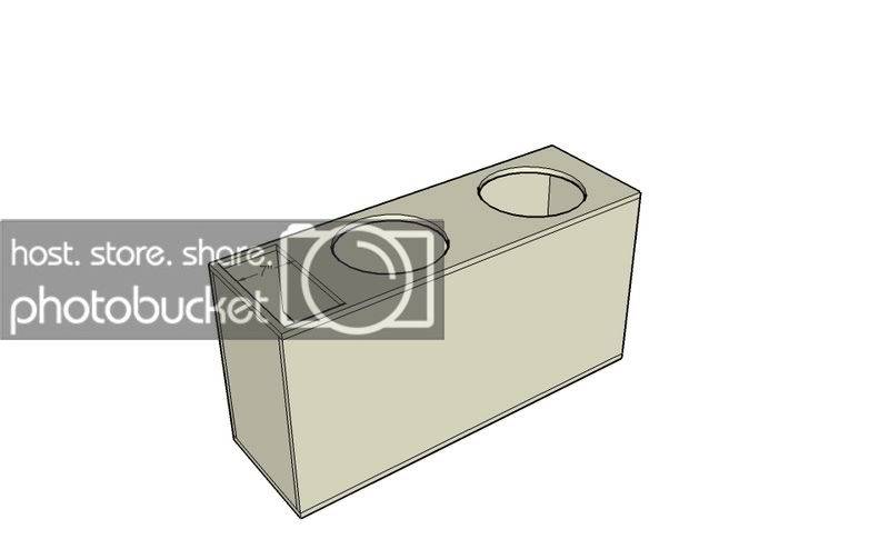

I will post up what it is supposed to look like when its done when I get the pic

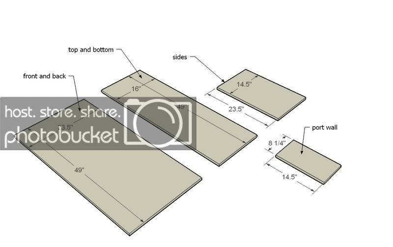

Edit: is it just me, or is something not looking right with the cuts?
Edit again: I just found out that the port needs to be routed out. I am waiting for the dimensions of how far out we would have to route. Or where the port wall needs to be placed
Ok, that should be pretty easy. That's going to take up **** near all of the wood so no room to screw up unless I decide to build one as well. If we have the table saw, the cuts shouldn't take over 2 hours for both enclosures.
I'm thinking about doing 2 tuned to 55 with about 60-70 in^2 of port for my 12. Might be a little too much port area though.. I'm not sure yet.
