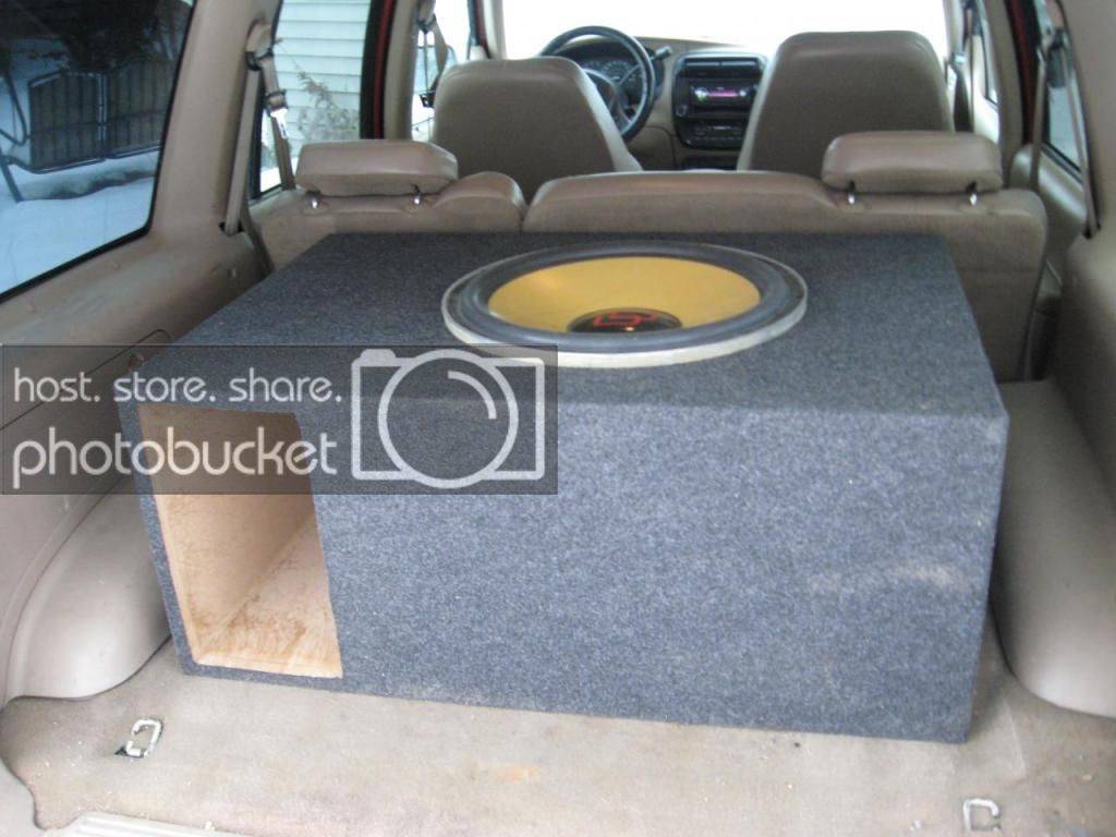

[quote name='mitchell0715']i cant stop thinking about the t-line @CSCStang made for 2 15's in his ext cab lol[/QUOTE]
Love this box. Musical, spl, bandwidth....has it all. More than satisfied.

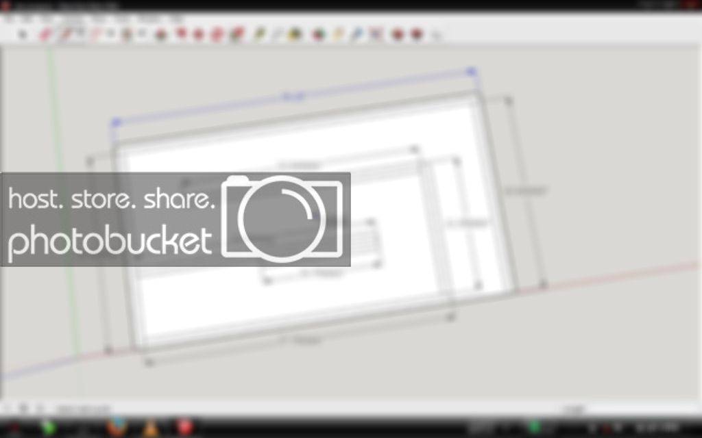

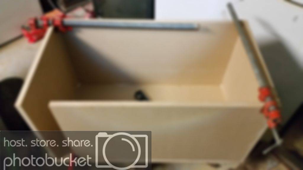

I started one for a Diamond Audio 12d2. Figured I'd play around with it since it's just sitting there. Been seriously thinking of doing a t-line for my D6 15" but it'd take then whole cargo area from the window line down.
@CSCStang has me trying to put everything in a t-line. So far the more I build the better they turn out.

[quote name='The_Dealer']I started one for a Diamond Audio 12d2. Figured I'd play around with it since it's just sitting there. Been seriously thinking of doing a t-line for my D6 15" but it'd take then whole cargo area from the window line down.
Sent from my Motorola 2950 Special Edition 3w.[/QUOTE]
I'm in the process of mocking one up myself for the d5 15"
