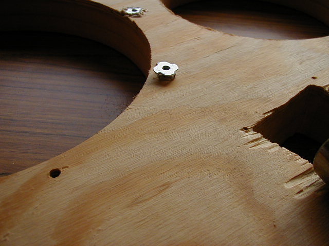

some of these;
install as so;
this is behind where the speaker is mounted (on the inside of the box);
works awesome.
lol thats what i said. but it was a good picture of them.
i think that particular configuration would be used to "tap" a piece of wood, and then mount somthing else behind it. if that makes sense.
well. whatever. im sure he can figure it out //content.invisioncic.com/y282845/emoticons/tongue.gif.6130eb82179565f6db8d26d6001dcd24.gif
Do i need to drill holes first for the drywall screws when screwing the woofer in? Or just a small hole to get the screw started so i dont punch a hole in my woofer?
i would seriously pre-drill your hole unless you want to risk popping a hole in the sub by slipping off the screw.
do it my way, and if you ever have to remove it for some reason, its easy and it wont destroy your box.
I dont understand how you put those in. I understand how they are in but how do i put them in.
the nut (with the teeth on it) goes on the back of the hole. the bolt goes thru the speaker hole, thru the hole in the wood, and into the threads on the other side. the teeth sink into the wood and hold the nut on the back, and they are 100% removeable so if you need to take the speaker out, the little "nuts" with the teeth say in the wood, and the bolts come out very easy.
its actually quite simple ddue.
