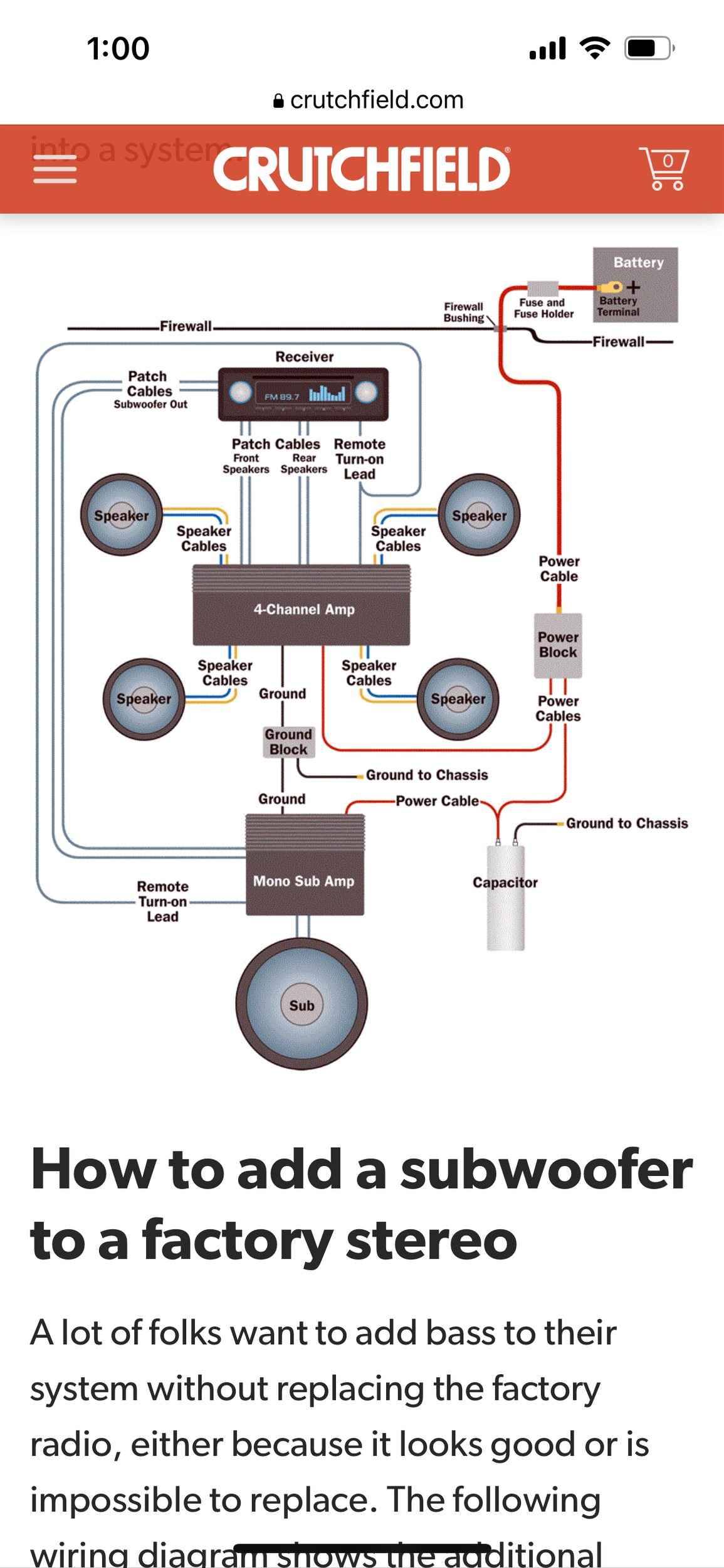

Basically i have a problem with my wiring, not sure if theres a short somewhere or what, hooked up my fuze to the battery(disconnected) reconnected the battery tried starting the radio and car and it didn’t start, took one side of the wire off the fuze and it started, last time i had help wiring this sub to my other car, but im doing it myself this time, anything im doing wrong? yes the amp is grounded

View attachment 48692This question could have many answers.

battery is fine, started right up when i took the power cable out of the fuze which is weird not sure if i have a short somewhere, the fuze is on the dedicated power supply, ground wire is bolted up to the trunk with paint stripped of course

so basically i didnt check all my wires, ground was touching the batt wire on the amp and was shorting out surprisingly nothing blew but the 15” is bangin now
