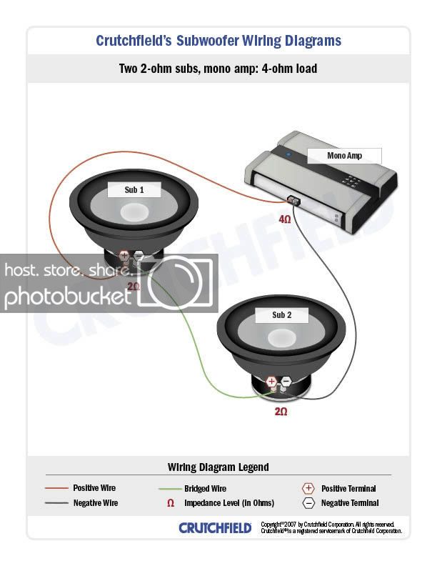

Wiring Question
im gonna wire my 2 12's 2 ohm and i was just wondering what is a bridged(green on diagram) wire (refer to diagram) Thanks
