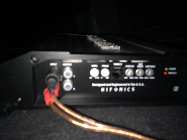

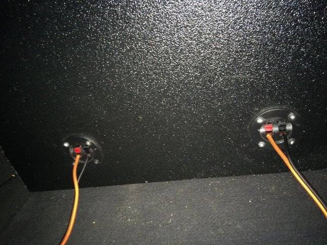

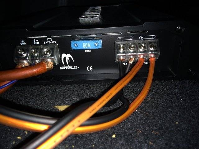

I tried to take some pictures, it's really late and my phone doesn't take good pictures in low light.
Any ideas as to why it's not receiving any output?
This is the side where all the knobs are, and there are two sets of RCA outputs, I put it on the left set because on the Hifonics manual that is where the "designated mono line input" is.
This is the back of my enclosure. At the back I wired them just straight to 4 ohms. I even checked with my DMM. It sits at exactly 3.8 more or less from the back of that terminal.
This is how I wired it to the amplifier.
Since the terminals look like this
I wired the subwoofers accordingly like this (first sub wires will be P1 and second sub will be P2)
P2- P1- P2+ P1+
Should I try to daisy chain it into one set of terminals instead? I mean even if I do that, I don't think it should solve problem because right now how I have it, whether it is at 4 ohms or 2 ohms, I should still be getting output of my amplifier to my subwoofers, but I hear nothing and I feel nothing coming out. :\ I tested the amplifier with my DMM and I tested the power terminals (not the speaker terminals) and I got a 14V with the car on so that's good. Amplifier is working. There's just gotta be one small thing missing. But I don't know what!
Please anyone help! I'd rather try and fix it myself before I turn it in to an audio shop and ask them to diagnose it.

Is the sub output on the HU turned on?
Yes. I turned it off and back on. And nothing. I haven't changed a single thing on my HU. Even with my last setup, when I sold it, I didn't turn off anything on the HU, it was still how I last left it. I initially thought that could've been the case. With the output off, no sound. But I double checked and it's on for sure!
