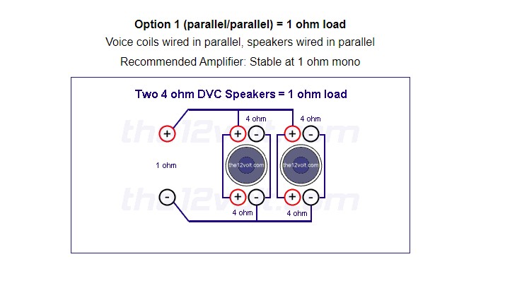

So im trying to run two 4ohm dvc 12in subwoofers to a 1 channel mono block amp everything i have read says i should run it in parallel was just trying to make sure om doing it correct. If anyone could offer any advice it would be greatly appreciated.
