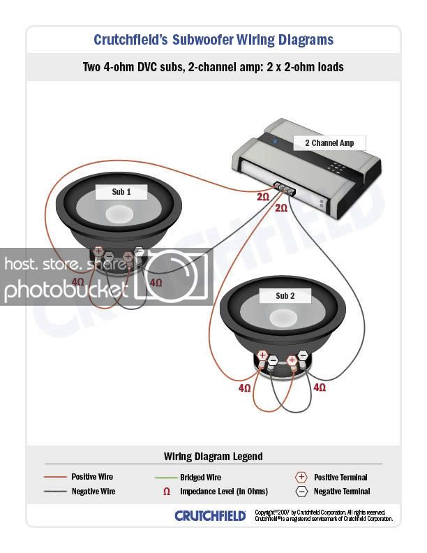

hmm just do it at 1 ohm. wire all the positives on one line and then all the negatives on the other and plug positive and negative where they go on the amp
its a profile ap2000 2 channel amp, 2 kicker cvrs 4 ohms dual voice coil.
amp:
subs:
12" subwoofer with dual 4-ohm voice coils
power handling: 50-400 watts RMS (200 watts per coil)
800 watts peak power handling

Since it's Dual 4s, they can be wired down to 2 ohms each. Or wired up to 8 ohms each.
Soo, to get 2 ohms at the amp do this -
Wire each subs to 8 ohm, and bridge both together @ the amp for 2 ohm load.
* 8/2 = 4 , then bridge at the amp is 2. Which makes it 2 ohm.

please explain this further
Hmmm... the (2) 8ohms brought down to the amp for a 2 ohm load?
Simple:
* 8 ohm Sub * ----------- * 8 ohm Sub *
_________Tied Together__________
* 8 Divided by 2 = 4 * - Which now indicates that you have a 4 ohm load
_________ Bridging your Subs at the amp _________
* The amp is INTERNALLY Bridged which now makes you 4 ohm load to a 2 ohm load
( 4 Divided by 2 = 2 ) Which now introduces your 2 ohm load.
Simple:
this part makes no sense at all....a 4 ohm load is a 4 ohm load....end of story ..just by connecting it to the amp does not change impedence..
....its not bridged internally....thats why it a 2 channel amp and secondly all you have to do is wire each sub to 2 ohms and conect one sub to each channel. the amp claims 400+ x 2@2ohms
you are making this alot harder than it has to be and beside even if your math is right, which its not, that amp is only 4 ohm stable in bridged mode
So you're tellin' me if you tied in (2) 4ohm subs.... It's not goin' to give you a 2 ohm load @ your amp?? How is my math incorrect?
I've been installing systems for a LONG time, I know exactly what I'm talkin' about.
