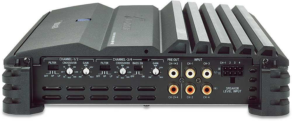

it has two RCA Pre Out. CH-1+3 and Ch-2+4.

Just run your RCAs from the head unit's output to the "CH-1 and CH-2" inputs on the amp. After than, run an RCA cable from the "Pre output" to the "CH-3 and CH-4" inputs on the amp. Adjust settings, and it should work.
