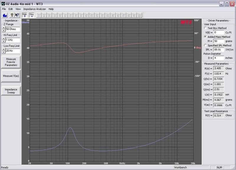

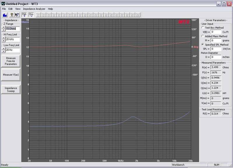

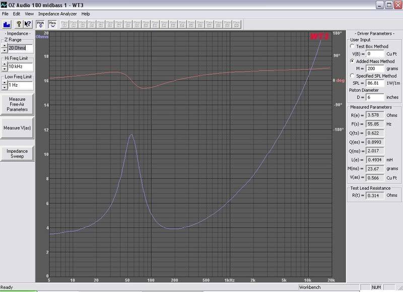

we say a speaker is "4 ohms" but that is just a nominal value. the actual impedance varies with frequency and 4 ohm is the minimum.
this is a 6.5" woofer
this is a 4" mid
this is a 1" tweeter
the impedance of the larger woofer or mid rapidly increases at some point. when wired in parallel the amp sees only one speaker at a time - even if the woofer doesn't have a low pass filter.

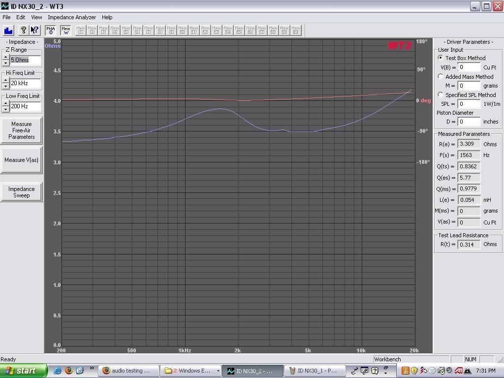

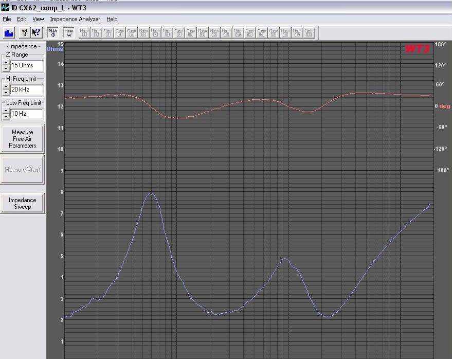

here is another set of speakers - Eclpise 8971 component set
tweeter only
woofer only
now let's look at what happens with a passive crossover (woofer and tweeter)
the filter network drives the impedance low around 5kHz to boost output. clearly, the woofer isn't playing a role here since it's impedance is 10 ohms at 5kHz.
now let's wire two component sets in parallel
and let's compare wiring them in series
lastly, there is such little signal strength at high frequencies, a lower impedance is never a worry.
You can't wire these speakers that way. The woofers and tweeters either need to be on separate amplifier channels or you need to use passive crossovers appropriate for the job. Bass blockers are just capacitors. I don't know how they will behave if you try to wire the woofer and tweeter in series, nor do I now how safe this is, but it seems like a bad idea.
as you can see, wiring in series simply doubles the impedance seen at any frequency. it's not desirable simply because the impedance peaks are so high the sound will be very unbalanced.
