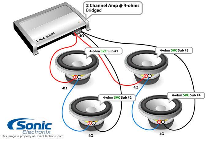

Yo, Thanks for the specs! It is a mono mix and the polarities are correct...I checked twice before soldering. Is it possible that if I wired the subs for a 4 ohm load, and the amp is rated for a 2 ohm load bridged, that this is why I'm getting bad sound? I'm guessing not, but below is how I did it for reference:
How would you suggest I wire them. Again, thanks for your help.
Try running each channel separately (not bridged) with two subs in parallel on each channel. This way each channel sees a 2-ohm load. Each channel would be connected like this...
I see, but won't I get more power from the amp if it's bridged (according to the specs)? If this is the way to go, I'll do it this weekend...I'll need to buy another set of terminals for the box, but I'll do whatever makes it sound right again.
You already said it sounds crappy in the bridged config - so, I do think it is worth trying as I've suggested above. It is not always about the watts - let your ears decide.
In theory, the amp would only be putting around 600 watts into your bridged config at 4-ohms and in the 2-channel config I show above it will put 300 watts per channel (600 watts total) so the 2-channel config is worth a try (in my opinion). By the way - I am highly suspicious of the '800W @2-ohms bridged' spec for this amp.
