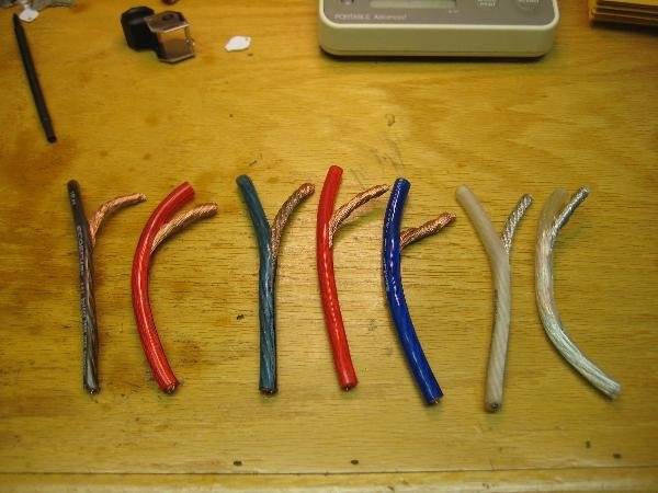

Today I took scraps from quite a few brands and did a little comparison. 6inches of each brand and weighed the amount of wire per section.
***I am not sure if all the brands are Oxygen Free Copper***
Some may be steel, CCA or other. Some brands were tinned (as you can see in pics). I had no way to test copper purity, this is simply measuring mass of the 'stuff' under the casing.

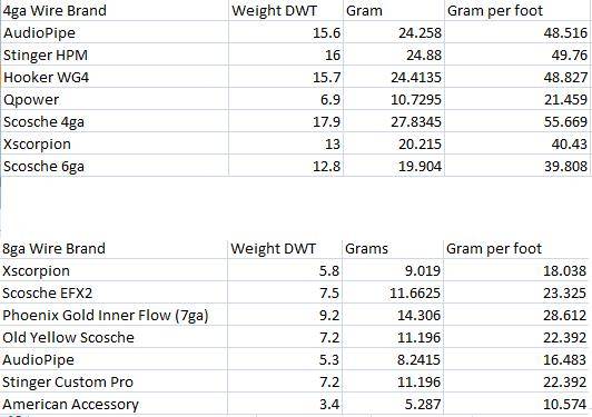

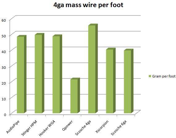

This should give a little idea of just how much you are getting per foot. In the charts, I converted mass per 6inches to mass per foot.

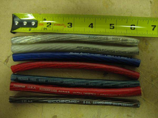

6" of each 4ga wire, list above is in order top to bottom.

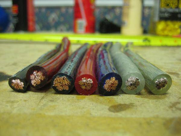

Cross section of 4ga wire, listed right to left

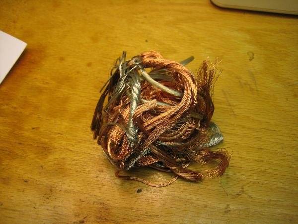

Wires split and copper pulled out of casing.

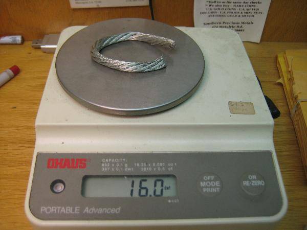

This is the scale used. It is calibrated to Pennyweight (dwt, used for measuring gold weight at the shop), I converted to grams for the charts.

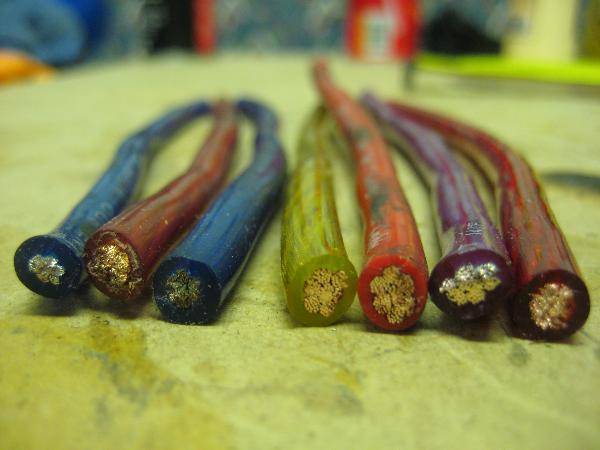

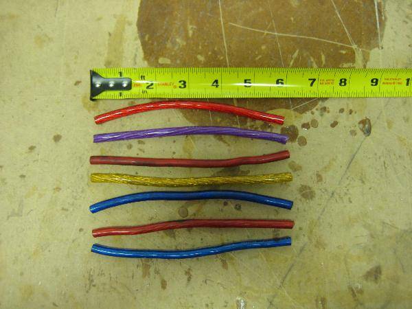

6" of each wire. List in the first post top to bottom
Cross section, listed right to left.

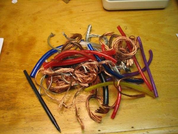

Bunch of scraps.

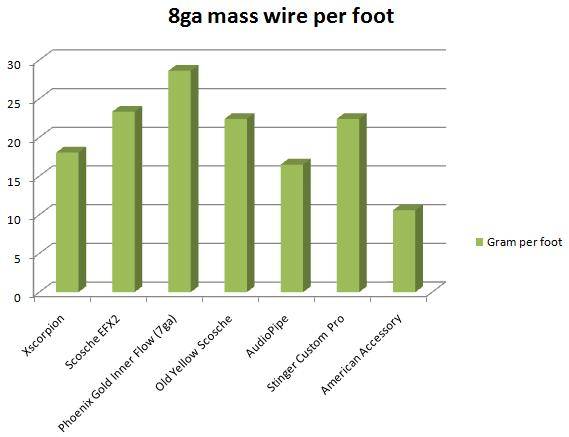

Wire masses
Charts
Take this as you will. I would love to know the copper purity in these wires.
The Qpower wire #'s where pretty much what I expected. Less than half of the other wire's average size. The Scosche wire really surprised me though.
Not sure if the Scosche is even copper, also it had very low strand count in comparison to the others.
