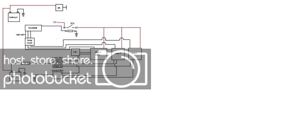

wire diagram
jmoreno150
wassup everyone just want to know if this look right or if im missing anything. any suggestions will be appreciated. thanks
oh i forgot to connect the rca output of amp2 to input of amp 3 is would that be correct? as for the subs i m putting 2 alphasonik mayhems12's, batterys i have one kintetik hc1800 but wanna add onemore in the trunk amps i wanna run to 4400 hk from ma audio or the 4000 for the subs, mids would be the ma 4channel 800 watts, and a 2channel for my kicks. im kinda new to this so i just wanna make sure. also the ma 4400 can acheive 4400 at 17v how can i acheive that, would i need a high ouput alt? what would you recommend?
What alt you got now check on the side of it should have a sticker or something on it says what amp it is most stock are 100. but alphasonic not the best sub's cause there still made by audiobahn i heard not sure but im not hear to put down your setup there not to bad i heard em but what wire you got running to em , what kind of hook ups as far as clamps and battery terminal hook ups go.
Connect battery negatives together with 1/0, not the chassis. Then connect your amps in the rear directly to the battery.
Most unibody vehicles have the approx. resistance equal to 4ga wire.
well i havent installed it yet. currently i have 2 800 series alphasoniks an they knock hard. my set up now is rears are 6 x 9 aplhasoniks, doors 4 x 6 alphas..., 4 100 rms tit. lanzar tweeters. amps i have 900rms alpha.... running my subs which is not enuff power, an rf running my speakers and tweets. . im going to ad the kick panels and build my box to specs for the new set up. probably use 8 gauge wire for the subs to amp and run 0 guauge dist. block and 0 to the sub amp also 0 for the ground dist block. i mean i have heard these subs at reg voltage on a 2000 amp and its crazy but i was just wondering if i can get my moneys worth doin that 17v deal but i guess ill just run it reg voltage and see how that goes. most likly i will replace the alt to a h/o. ill take pix and post them so you guys can see. but thankx for the help guys. any suggestion are still welcome.
