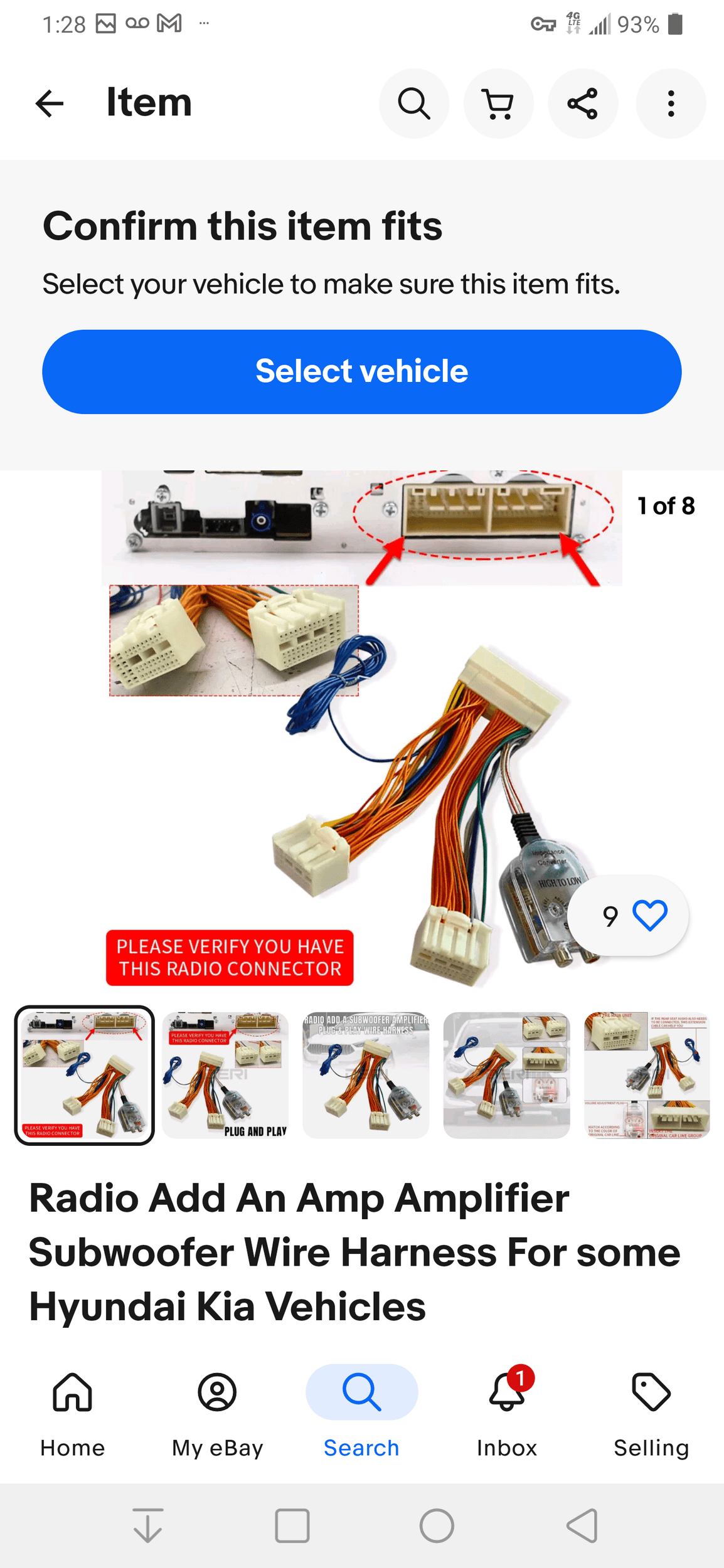

If removing the radio to take a peek at the plugs is not too hard, you can see if this harness will work for you.
