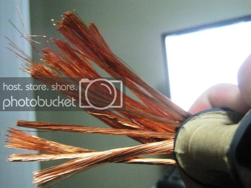

If the rope specs are accurate, then it does have a larger area then the KLMX 4 gauge, but around 30% smaller then our CCA 0 gauge. If you strip the jacket are there several small ropes within the 7 cores? Looking at the cross section, you see 7 bundles (ropes/cores) these are often made up of smaller ropes. According to Cadence each of the 7 large ropes is comprised of 7 smaller ropes. Its hard to see from the cross section, you would have to strip back about 4-5 inches:
This photo shows DB link pulled apart from the kit review we did and you can see the smaller ropes within the 7 cores
http://www.knukonceptz.com/images/kitreview/db.link.core.jpg
i don't have any more free wire but when i get some tomorrow ill take a look. does it make a difference if there are ropes within ropes? i'm assuming it would be wound tighter this way, meaning more wires packed into a smaller overall conducting diameter?

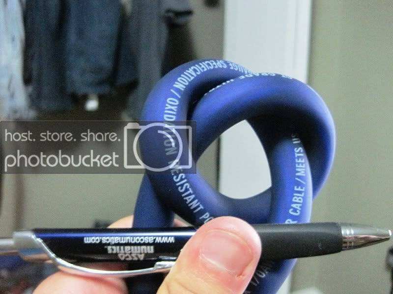

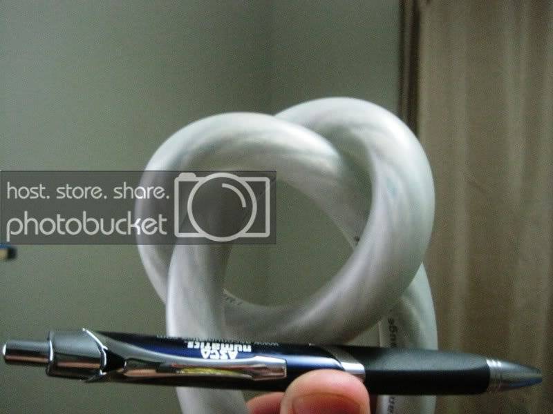

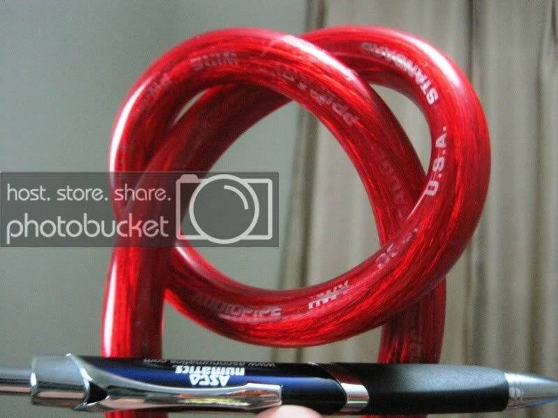

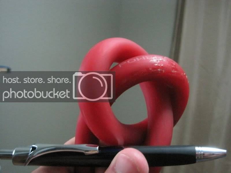

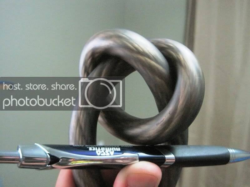

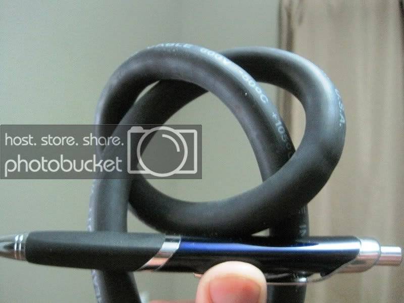

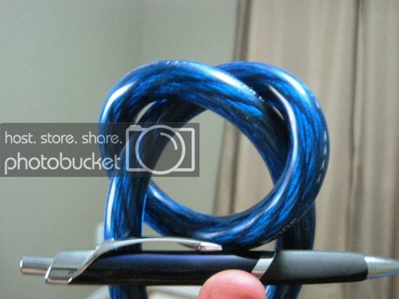

14. Flex-A-Prene Welding wire wasn't to easy to flex and bend but it was do-able, one thing worthy of mention is there was a cardboard liner on the inside of the jacket it made a cool noise when I cut it. also I noticed that these strands were a lot thicker and were straight. The price on this wire which I found on ebay which was being sold as fork truck/ welding wire was quite reasonable and down to earth, the only down side to it was it had the least conductor OD of all the wires viewed today.
15. Audiopipe, this wire was difficult to bend, and the cost was very cheap! The price I found was on ebay and it came to 1.54$ per foot, but worthy to say the conductor OD was on the average size so this will get an average rating although I suspect this from CCA wiring
16. Bullz Audio was another one of those super hard ones to bend but it was also the cheapest wire I was able to find, with the cost being 1.06$, and Conduct OD was also average on it.
17. IXOS, is the next on the chopping block. This wire is what some would call the holy grail, or rather an infamous wire as it was the most expensive wire I have reviewed. The bend-a-bily of this wire was extremely easy to bend and offered little resistance, and yet again the conductor OD was yet again average.
18. Kicker, yet again another fan favorite, this one was also very easy to bend and the conductor OD was above average here. the only down side was the price tag.
19. Mobilespec, a brand I personally haven't heard of and it was a bit hard to find a price tag on this wire but I eventually did and I got 3.7$, which is a bit high, the bendy-ness of this wire was horrid and the conductor OD was under the average overall this wire wouldn't be my favorite pic.
20. And last but not least Shoc Competition OFC wiring. This wire was very easy to beind and one of my favorites to bend! The price is unknown as it is currently discontinued from what I can tell, and it has the average conductor OD of the wires viewed today.

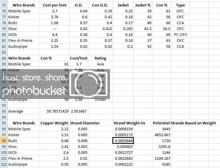

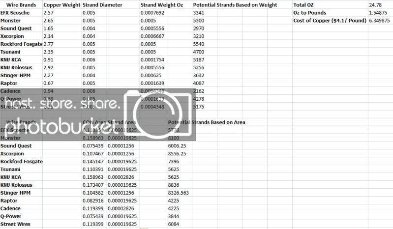

Just like last time I gut a 6inch section from each brand and cut the jacket off to reveal just the copper and I weighted that copper and displayed my findings.
Based off of my findings with the tobacco sale I would have to pick either KNU KOL, Kicker, RF wiring and IXOS , as they all showed a lot of copper content. But based on price and copper content I would have to pick KNU KOL over all the brands and a close runner up would have to be the welding wire. I would have picked Kicker or RF or IXOS but their pricing is a bit high as compared to KNU or even Welding wire which is an excellent runner up for its 3-3.5$ price range. Also please note that since I did this review KNU has raised there price of the KOL wiring and it is still a better value!
So with this I would like to conclude and say I had a lot of fun doing these reviews a I have learned a lot about 1/0 and how companies will all vary but please keep in mind that the Conductor Diameter of 1/0 wiring should be around 0.325" as per the standards I have read on the web and all of the wires are over this standard. (American Wire Gauge table and AWG Electrical Current Load Limits with skin depth frequencies)

Hi Ken,
Just a quick note about that table you referenced, the diameters listed are for solid wire standards. Stranded wire must be larger diameter to compensate for the air gaps between each strand. Stranded wire 0 gauge according to AWG should be 9.53mm (or .375") in diameter.
