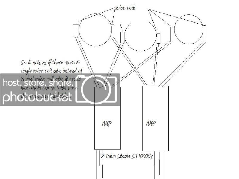

ok first this is not my wiring diagram. i dont think it will work like this but i figured i would ask
the kid has 3 l5's they are dual 4's he wants to run them down to 1 ohm and put them on 2 memphis st1000ds here is the diagram
????will it work????
what do you guys suggest as far as wiring???
thats what i came up with borrowed from rockford and tweaked a lil
so this will work or would it be better just to get one big amp thats 1 ohm stable and wire them down to .67 ohm????
1 ohm amp would be less wiring,i.e. expense, probably save space too. Also if one amp goes out in that set-up it could damage the speakers.
