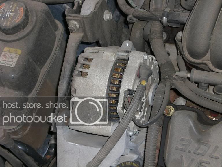

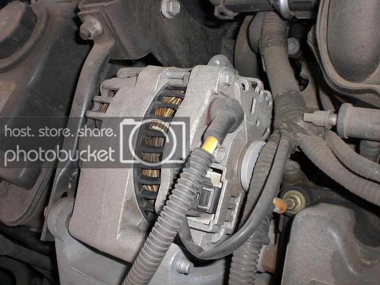

im going to be putting a 15" Fi Q and a RF T10001bd in my 01 taurus pretty soon, will my stock alt hold up to that? if not, would simply doing the big 3 help it out? i tried looking for the model or type this morning, but theres no tag on the alt itself..heres a pic though?//content.invisioncic.com/y282845/emoticons/rolleyes.gif.c1fef805e9d1464d377451cd5bc18bfb.gif

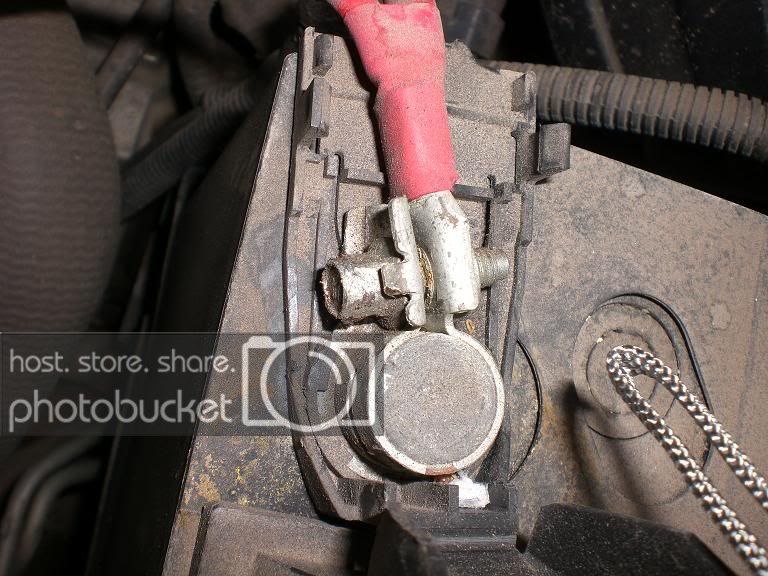

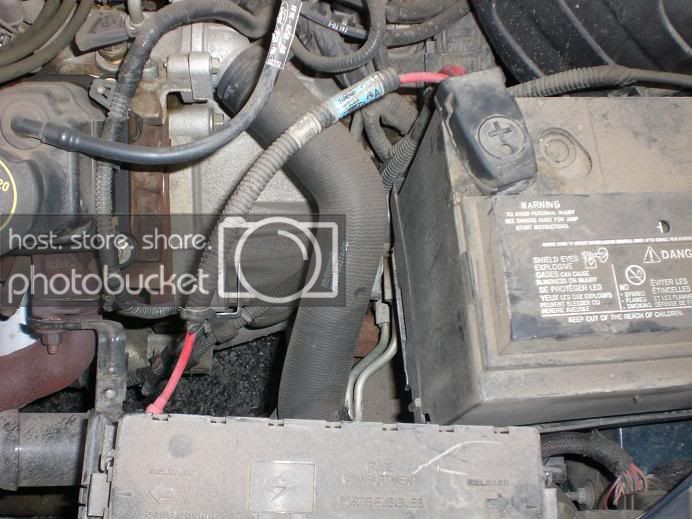

and since were on the subject, i have this for a terminal connect, since ill haev a run of 4 awg for my amp and another run of it for the big 3...will i need a new connector? or just putthem all on that bolt? AND it goes into the fuse box, so what do i do there?//content.invisioncic.com/y282845/emoticons/frown.gif.a3531fa0534503350665a1e957861287.gif
go on ebay look at parts for your car then look up alt of corse an then they will list the amp on there then come back an tell us.. an also change the termanals for sure those are the worst kind they dont hold tight hope this helps. one an one more thing an alt is supposed to run at 80 % of its rated power, so u can get a d/c amp clamp from some one an play the system maxed out then put your lights heat an whipes on that will be probly the only time all of these factors will come in to play an if your 80% an under your fine then..im a macanic so i know.. an im running 2 12" with a 1700 watt amp an a 80 amp alt ,, well lets just say wen i turn everything one i get 120 amp draw which is real bad for the alt considering its a 80 an it puts out 120, so it will probly die soon.. hope it helps

oh, sorry i forgot to mention go to autozone.com or napa,ect... and put your vehical make in & engine size, look up alternators and you will know what kind of alt you have. by the way napa has some really good heavy duty stuff(battery post clamps,ect..)

about the taurus, your alternator is most probably a 110amp, for now do the big 3 and set the gains correctly and you'll be fine, but to get the most out of your amp you may need to upgrade the alternator in the future. RF power AMPS produce serious power, watch for voltage drop as it will smoke your amp
