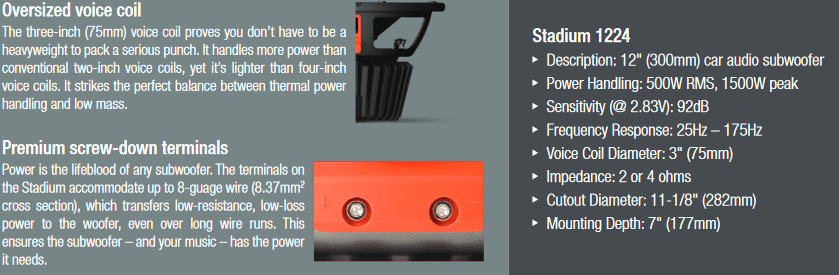

Hi, I'm very new to this car audio thing but I had my eye on this sub woofer for a while now but I'm not quite sure if my chosen amp will be able to power my sub to its full potential or be able to power it at all. I haven't bought anything so I'm open for suggestions. The sub I had is mind is:
JBL Stadium 12″ 500rms DVC Subwoofer , which is supposed to be switchable between 4 and 2 impedance.
The amp I think maybe would work is:
Targa TG-SV8000.1 8000W Monoblock Amplifier, which is rated at 400W RMS @ 2-Ohms
Please and Thank you :)

Please double check that sub. DVC is not going to be able to do 2 or 4 ohm. The final impedance you'll need to drive is either half or double what the coils are. SO dual 2 ohm would wire to either 1 or 4, dual 4 ohm would wire to 2 or 8.

If I look for subs I struggle to see if the sub is SVC or DVC. That title was just advertised as DVC at an online shop but I went to the JBL web page to find the next information but still are unable to tell if it is DVC or SVC or I may be just missing something
Can be 2ohm or 4ohm you choose by the selectable switch. Only one positive and negative connection. Looks like it has dual coils that go to the switch? Not sure.
You're right, it must be dual (or quad) coil to have multiple impedance options. If your choices are 2 or 4 they must only be using half the coil in one of them..
Either way, it's safe to say that you can indeed select between 2 or 4 ohm.
