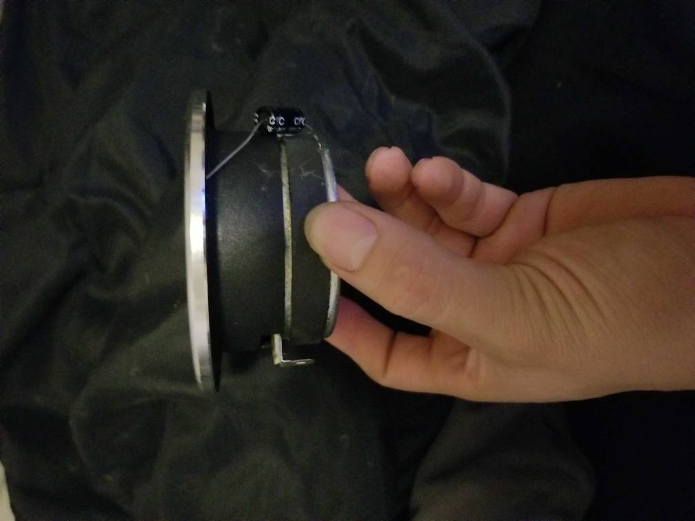

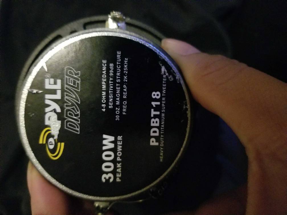

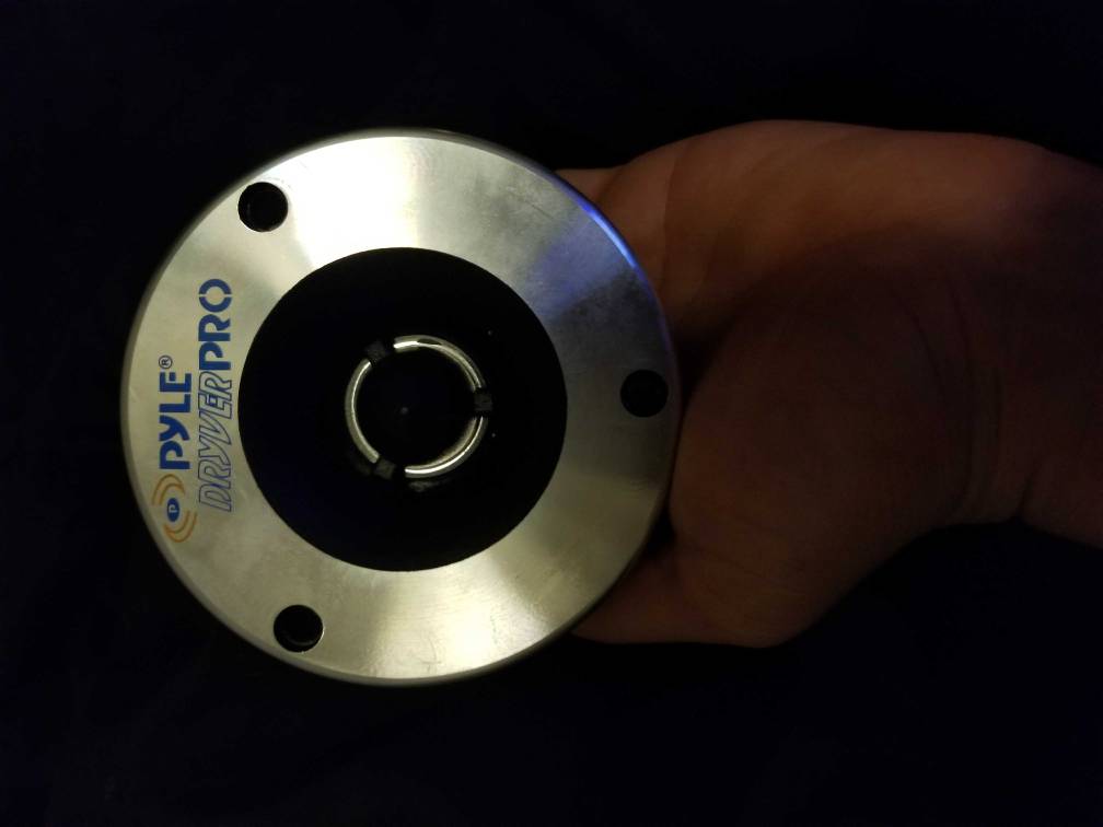

Some bigass tweeters..
3 3/4 tweeters [emoji23][emoji23]?

Did your 300 come with the 3 dash holes for 3in tweets?
I was able to put some soundqubed super tweeters in mine amd just place the wire mesh back on without needing to screw them in place.
They fit perfect.
yeah if that 99db u may wanta just put them on hu..
Thats my plan one day if i can get custom a-pillars done lol, i messed up one door panel trying to make a hole just to give up since the magnet is so huge i have to cut all the metal off the door.
