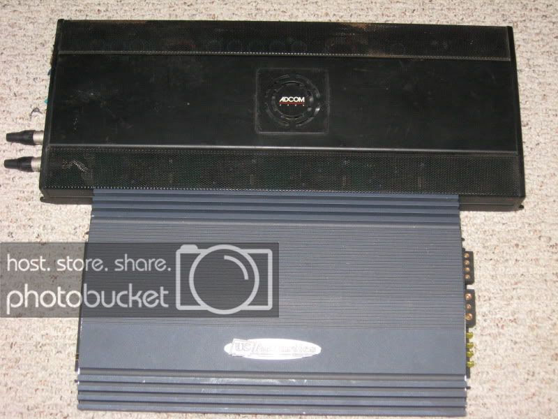

Well as predicted, Time constraints have lead to a lack of progress. Here are the 2 things I do know that I am using at this point. 40lbs of amplification
Adcom GFA-4404 for the front stge and USAcoustics USX800f (thanks pickup1) for tha boomz.
IMO Adcom are quite affordable, especially when you look at what USAmps and SS of the same time frame go for. I have a black 4304 I will likely be selling.
