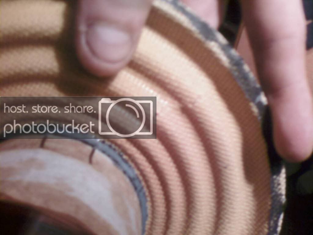

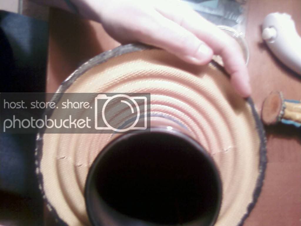

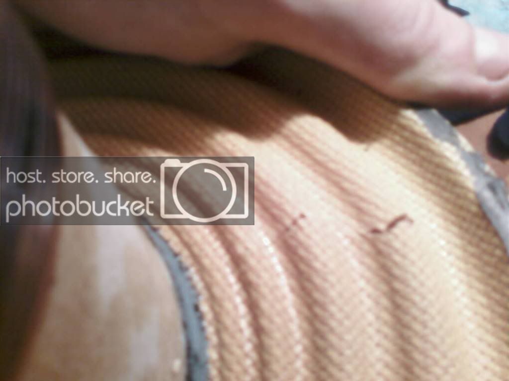

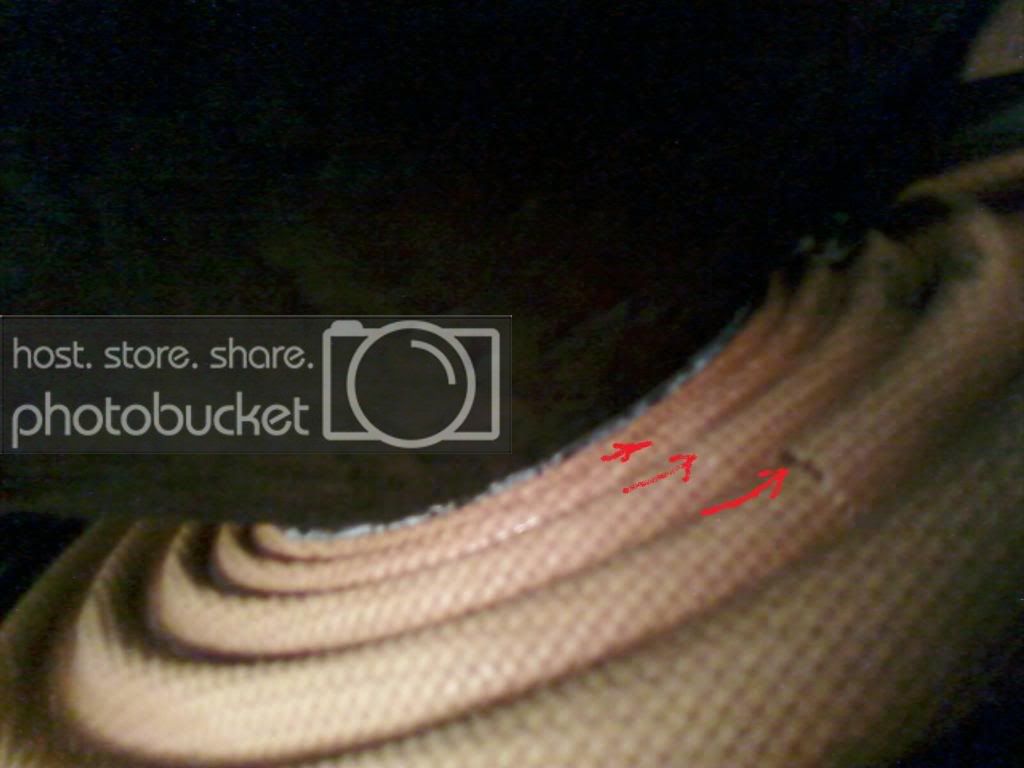

started hearing some noise from my btl, pulled it and....
box is 6.18^ft @31ish (thought it was lower, ran my #'s on ssa box calc, it said 31.xxxx)
power is an orion 2500d@1.5 ohms, ssf set at 30, reconed in feb using parts from team psi
'Using parts from TeamPSI' does that mean you did it yourself? I would say weak spider, or if you did it and didn't align it properly it could just flex and crack (like a coat hanger bending it a whole lot at once.)
