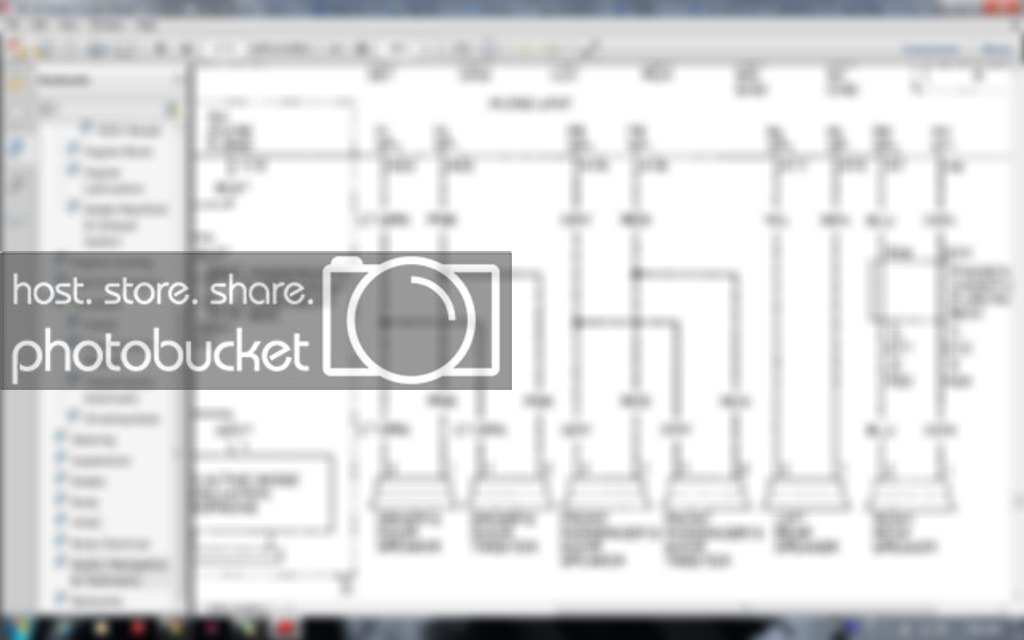

i have a question though. how do i install the tweeters? i read that i install the tweeters back to the midrange tweeter terminals (where i disconeccted it from) with extended wires ? how would i send my tweeters to the amplifier then to adjust it individually?
this is what im going to do.
remove my lc2i form the rear speakers and splice it to the front speakers to catch signal. then im gonna send wires from my amp to the midrange woofer to give that sound, what about my tweeter? just connect it back to the midrange or is there a way to get sound from the tweeter by connecting it to the amplifier? maybe my tweeter wires is connected to the midrange on the factory setup so ill give it a try
this is my wiring diagram for my car if thats any help to anyone. looks like the tweeters are just spliced into the speaker wires for sound. so how would i go about installing my tweeters to my amplifier?
Your diagram is showing the factory tweets wired in parallel with the mids, which means the factory crossover capacitor is probably located on the tweeter itself. You can use the same wiring if you install a 2.2 uF cap in series with the tweeters. Otherwise, the Imagine's crossover cap is attached to the woofer, and they have provision for you to make the tweeter connection from there. But you'd have to separate the pink and red wires in the doors and connect them to the 3rd terminal at the woofers.
im not quite understanding this exactly. what do you mean seperate the red and pink wires and connect them to the 3rd terminal of my imagine woofer? which one is the third terminal? the (-) of the cap on the tweeter on the imagine?
Sorry, I read your diagram wrong. The red & pink are negative. You will need to disconnect the positive sides (lt grn & gry) of the tweeter wires and connect them to the crossover caps on the mids. Or just run new wires from tweeters to mids. It's explained thoroughly in the owner's manual.
