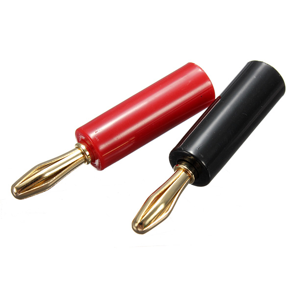

Like this but I'm not a fan of these because you can tighten the screw down from amp to the input. Like it gets tight but any vibration will make the terminal loose in the amp terminal hole. If u get what I'm saying
What is that? I have no clue what you're talking about, and that looks irrelevant to what I'm talking about. I think I'm confusing people.
