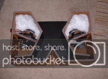

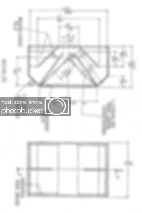

Well...let me see if I can illustrate this.
With my height being able to go 15 in. I can mount the subs vertical. So what I am thinking I would like to do, is basically build a box just like my present sealed one, but with the subs inside firing at each other, facing the middle of the box. I would put a piece of wood down the center of the port to prevent cancellation.
How am I doing on the wondering part?
remove the piece of wood and youre golden.
if its off by the slightest, it will cause you massive problems
