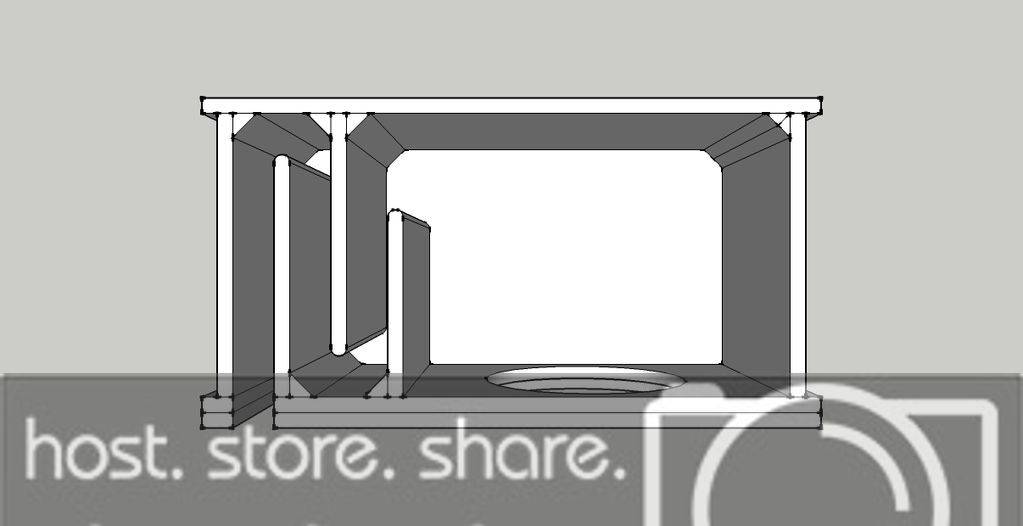

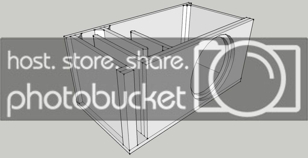

So I drew up a quick sketch, I'm looking at just under 2.5cubes. It'll be an AQ HDC3 12" going into it. And since I've had a lot of luck with sub firing sideways, port facing back in my Grand Prix I think it will work good.
My question is, is my port too skinny? Considering it's 13"x2", thats only 26sq inches of port area, will that cause port noise or any other problems? According to the Carstereo.com calculator its going to end up being around 28hz. Any help is greatly appreciated.
An "L" shape is a slot port meaning that the atleast one side or more of the box is being used as a port wall. The design I have is a slot port but due to the overall lenght to acheve the desired tuning of 30Hz the port has to be wraped in order to fit. The port on the box is almost 40"s long to tune the box to 30Hz. The port on that design is done properly with rounding all port edges and placeing 45's in every cornen to maintan the exact width all the way down the port. I can work with you on the design if you want. Just PM me.
