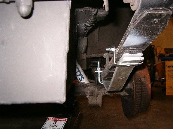

the helper springs from local autoparts stores are cheap, and very easy to install....they are adjustable and will raise the vehicle plenty far enough
if you actually drive it. the helper springs are rated at around 2000lbs i think. you can get springs or leafs. air shocks most likely wouldn`t last very long with that much extra weight.
air shocks FTL. They put all the weight on the upper shock mount which was NOT desiged to support the vehicle.
Get a set of Air Lift air bags or a helper spring and be done with it. Peronally I'd do the air bags as you can adjust them and hopefully won't end up with it riding like a dump truck.
