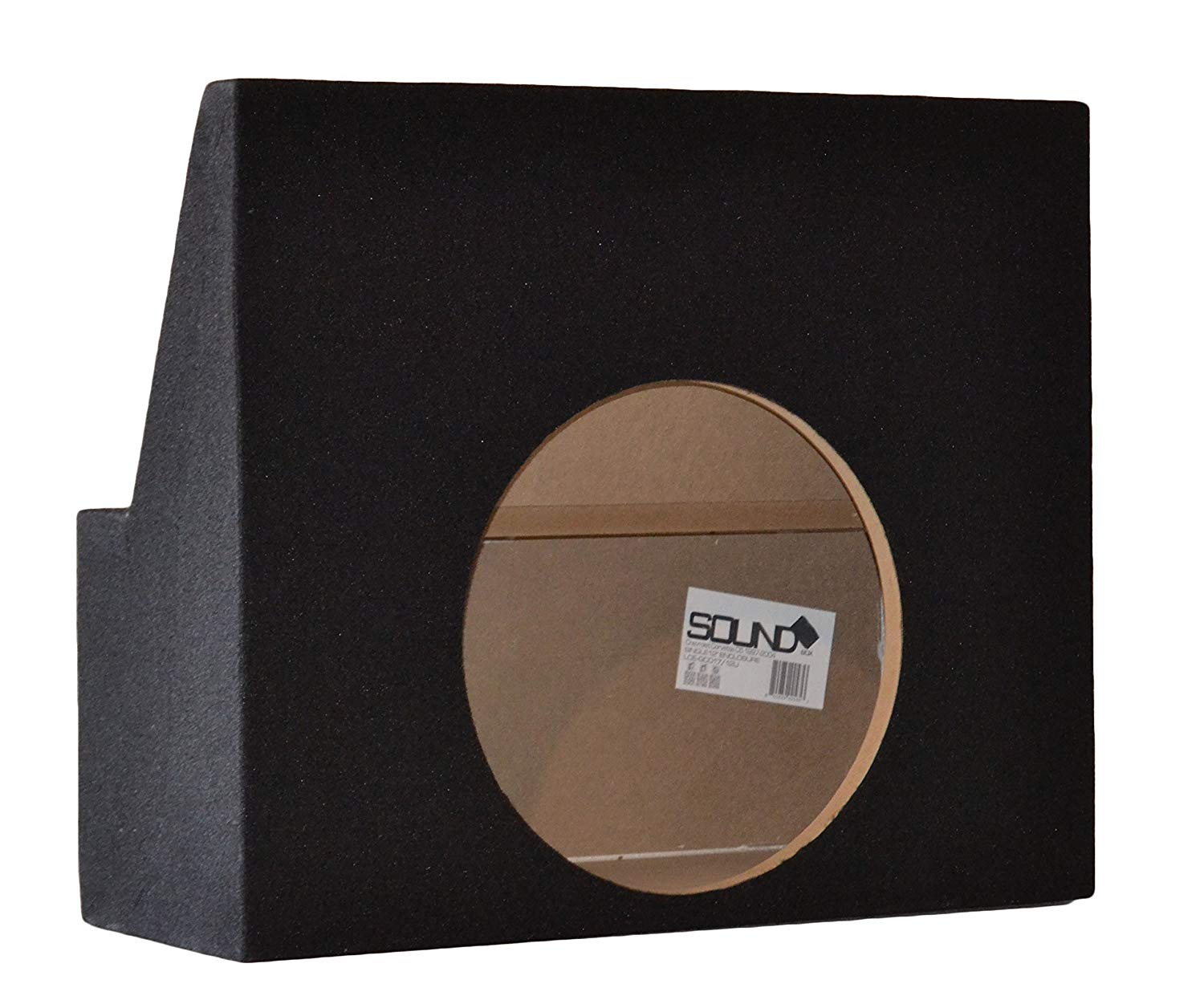

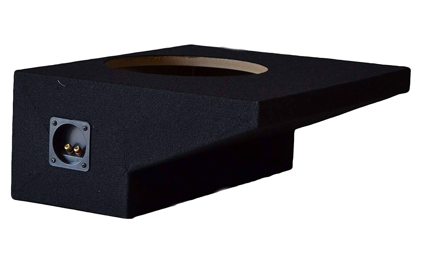

Hey there thank you for the information very helpful I do have one more question though. The ISF filter for a sealed enclosure with 0.80 ft.³ of air should be set at what? The box that I have installed looks like this.

As you can see the enclosure fits very flush due to the custom molding for the vehicle. The only problem is its only 0.85cuft of airspace and hardly any depth.
Here is why such a great design falls short.
When I originally bought this box I had a comp VR 12" Sub ready for it because the specs said 7 3/8" deep. Then I had to return the Comp VR for a PR-12 Memphis Shallow. The magnet would hit that lip making it impossible for any normal size sub to fit the box properly. So if you have ever have thought about buying this box for your vette be very aware of that lip. As it severly limits your subwoofers to choose from.
