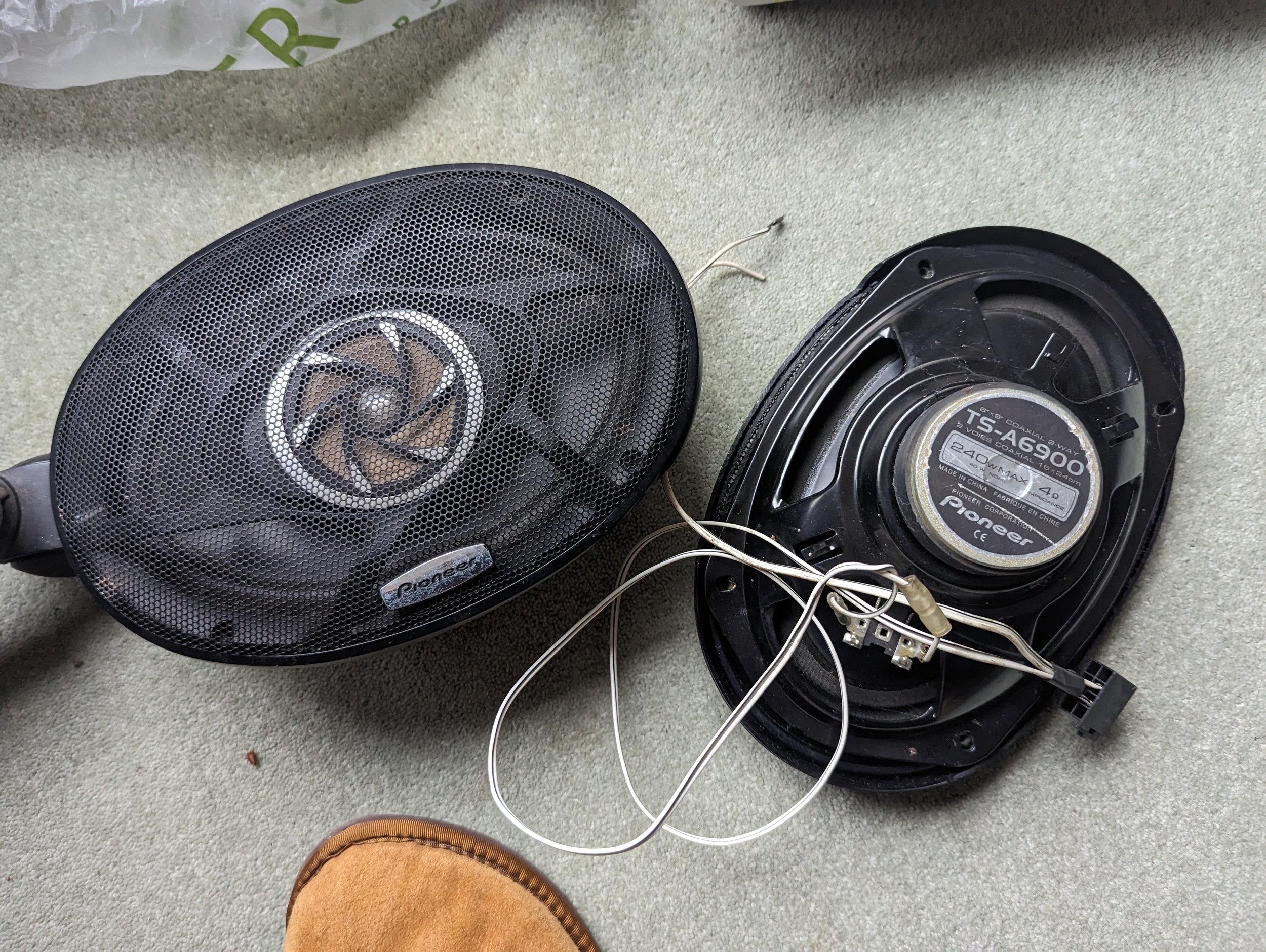

I have just found a pair of Pioneer TS-A6900 speakers in my parents home. They look lovely, but I can't find anywhere online talking about which part of the car these should be installed in!!?? They look like the parcel shelf kind of speakers to me, but at the same time, they aren't a tally 'subs' (when I looked them up online), but due to their shape, they wouldn't fit in any of the doors on my car I have (Vauxhall Corsa D 1.4), so where the **** should I be installing these?
Likewise, any one know HOW I even install these? Do I need an amp? Honestly I'm just so confused.
Any help would be immense.
Sorry forgot to attach an image ...

Those are only 40 rms 6x9s and really not a great speaker. I would check them with a DMM to see if they are still reading the Ohms value @4 or close to 4 ohms. Look at the surrounds to make sure they are not cracked or separating. Id prob just make a little speaker box to put them in if good and use in the garage
Search the exact "year and model" of your car while including front speakers / rear speakers to find out what sizes are in it from the factory. That info is usually easy to find. Googling similar cars to yours, I'm guessing it doesn't use 6x9's, more likely 6.5 front and rear. 6x9's are more common rear speakers though.
But yeah, those Pioneer's are pretty old. And while they probably sound fine on a stock system, more than likely no better than the stock speakers you currently have.
