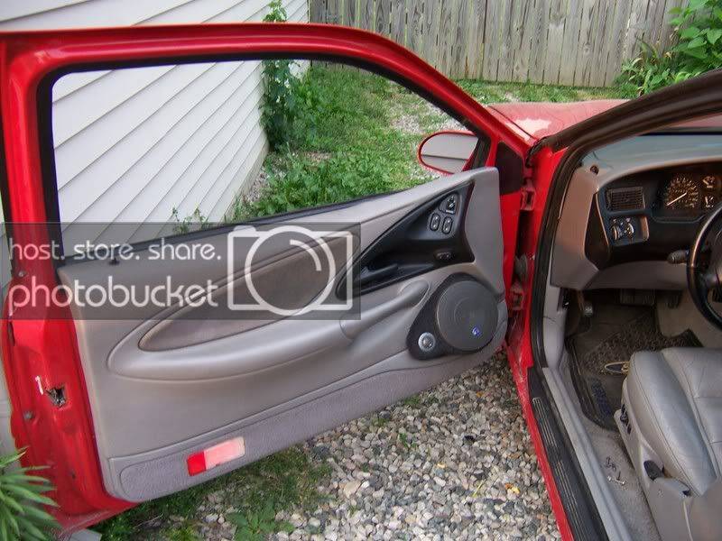

Mine are in my doors.....on an MDF spacer to bring them out from the door panel far enough to clear the window mechanism.
My car originally called for 4" speakers in the doors behind a factory grille. //content.invisioncic.com/y282845/emoticons/crap.gif.7f4dd41e3e9b23fbd170a1ee6f65cecc.gif
6.5" midwoofers didn't want to live in the stock location in any shape, fashion, or form so I had to space them away from the doors.
