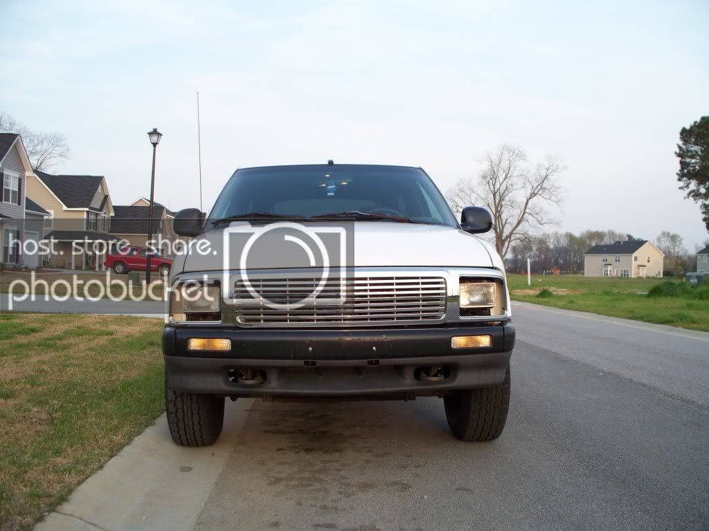

rather, run it thru your front windshield along the weather stripping, mounting directly in the middle to the metal on the roof, ensures great signal and location.
like so..
see right in the middle
dont mind the headlights. im gettin some.♦
I'm sorry but that looks tacky as hell IMO..
