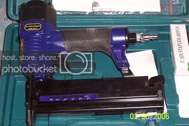

Brad Nailer.
nG
$10 brad nailer that has lasted through a gajillion enclosures ftw //content.invisioncic.com/y282845/emoticons/smile.gif.1ebc41e1811405b213edfc4622c41e27.gif
I have a Hitachi one that shoots 1.75" brads I do believe... love it.
If you're going to start listing air tools, wouldn't the compressor be the tool you can't live without? //content.invisioncic.com/y282845/emoticons/wink.gif.608e3ea05f1a9f98611af0861652f8fb.gif
